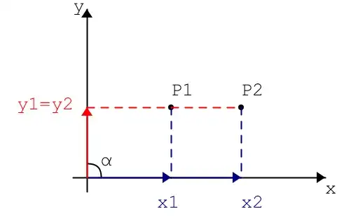

I believe a good point of view is the concept of orthogonality.
This is clear under everybody's eyes when seen in physical space, take for instance a 2-dimension space, a plane.
In the example above any point on the plane can bear two indipendent informations, its x and y. The keyword here is indipendent, I can freely change one, let's say go from x1 to x2 while leaving the other unchanged.
This indipendence is given by the orthogonality of the two axes choosen, in the plane depicted we may say that $\alpha=90^\circ$
In more general way we might say that orthogonality/indipendance is given by the dot-product of any vector laying on the two axis being zero, for instance $$\bar x_1 \cdot \bar y_1=|x_1|\,|y_1| \cos \alpha=0$$
This same concept of orthogonality can be extended to any space where such a dot-product can be defined.

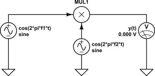

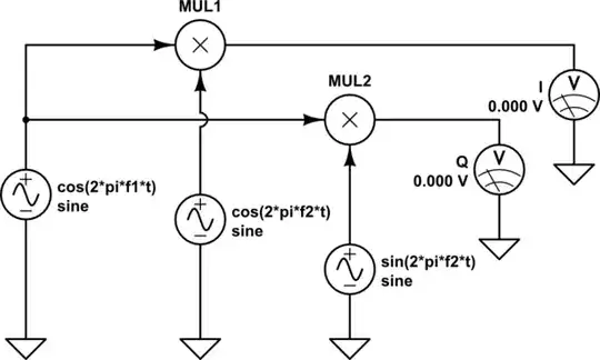

First let's look at what happens in the case of a single mixer:
schematic
simulate this circuit – Schematic created using CircuitLab
We know that mixers produce sum and difference frequencies. That is to say, the Fourier transform will contain impulses at $f_1 + f_2$ and also $f_2 - f_1$. Or is it $f_1 - f_2$?
It doesn't actually matter, and it's important to understand why. The Fourier transform is defined in terms of complex exponentials:
$$ \hat f(\xi) = \int_{-\infty}^\infty f(x)e^{-2 \pi i x \xi} dx \tag 1 $$
By Euler's formula:
$$ e^{ix} = \cos x + i \sin x \tag 2 $$

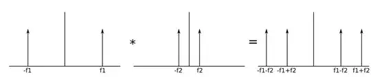

To by taking the Fourier transform we are convolving $f(x)$ with a complex exponential at every possible frequency to answer the question "how much does this function look like this frequency?"
But the inputs and outputs to this mixer are single voltages and thus must be real functions, so how can real functions look like complex exponentials which have a non-zero imaginary part?
To resolve this, it's important to understand that a real function can be represented by adding together complex exponentials of positive and negative frequencies. Brian K1LI has provided a nice graphical animation of this. You can also convince yourself that $e^{-ix} + e^{ix} = 2 \cos x$.

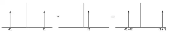

With that in mind, what's the mixer above do? Multiplication of two functions is equivalent to convolving their Fourier transforms. So considering that real functions have Fourier transforms which are symmetrical about frequency 0, what the mixer above calculates is:
Notice that the assumption is made that $f_2<f_1$, which makes $f_2-f_1$ positive. But if it was the other way around it wouldn't matter, since a negative answer is also correct. Because the output of this mixer is a real voltage, the Fourier transform of the output must contain both positive and negative frequencies.
Because real functions have Fourier transforms that are symmetrical about zero, talking about their negative frequencies doesn't add any insight. But it is critical to grasp that they are there anyway, because that leads to a much simpler mathematical explanation, and thus better intuition about how things like mixers work.
Now what about an IQ mixer, like this:
schematic
While your first instinct may be to think of this as two mixers, I find it more insightful to view it as a single mixer which can operate on complex numbers by representing the real part as one voltage, and the imaginary part as another voltage. Viewed this way, this mixer is simply multiplying by a complex exponential:
$$ \begin{align} y(t) &= \cos(2\pi f_1 t) \cdot e^{2\pi f_2 t} \\ &= \cos(2\pi f_1 t) \cdot \cos(2\pi f_2 t) + \cos(2\pi f_1 t) \cdot i \sin(2\pi f_2 t) \end{align} $$
Recall from equation 2 that the $e^{2\pi f_2 t}$ is comprised of real cosine and imaginary sine terms, which are the inputs to each branch of the mixer.

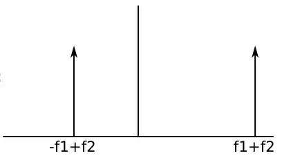

Now the complex exponential, unlike a sinusoid, has a Fourier transform which doesn't need to be symmetrical about zero. So in the frequency domain, this mixer calculates:
Now the output isn't symmetrical about zero in the frequency domain, and so negative frequencies have some utility.
Notice that there are now half as many impulses in the Fourier transform. The mixer no longer calculates sum and difference frequencies, but just sum frequencies. Pretty handy, if we can figure out a to separate negative and positive frequencies! But...

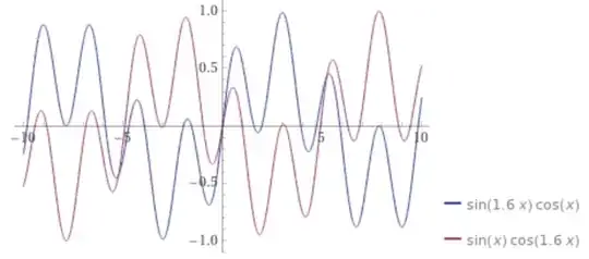

Explanation 3: mixers
This is not a complete explanation, but maybe insightful regardless. Consider the multiplication of a sine and a cosine, of different frequencies. In one case the sine is 1.6 the frequency of the cosine, and in the other case the cosine is 1.6 times the frequency of the sine:
You can see in either both the upper and lower sideband. But notice that the phase of the upper sideband is equal in either case, while for the lower sideband the phase is opposite in each case.
Notice also this doesn't work when both functions are $\cos$, because obviously
$$ \cos(x) \cos(1.6x) = \cos(1.6x) \cos(x) $$
So clearly there is some way to distinguish between signals that are above the LO versus those that are below, but it only works when the inputs are in quadrature, which is why if you don't know the phase of the signal you're looking for, you need two mixers to do this trick.
Now back to our problem. We're looking at the output of the IQ mixer, which has a Fourier transform like:
If you were to casually look at either the real or imaginary parts of this mixer output, you might not notice that it's different than the single mixer case. Given the above explanations about negative frequency, you can tell from this Fourier transform that the impulse at $-f_1+f_2$ still means something is happening $|-f_1+f_2| = f_1-f_2$ times per second, just as before. You can't tell that it's a negative frequency because what makes it negative or positive is not how many times per second it happens, but rather the relative phase of when it happens between the imaginary and real parts. You can't tell that by looking at just the real or just the imaginary.
But if you were to look closely at the thing happening $f_1-f_2$ times per second, you'd notice that it happens first on the real part, with the imaginary part lagging behind 90 degrees. That is what makes it a negative frequency.
You would also notice something happening $f_1+f_2$ times per second. But there you would notice that it is the imaginary part leading with the real part lagging. That is what makes it a positive frequency.

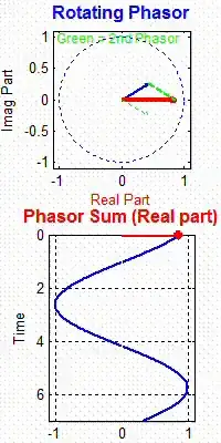

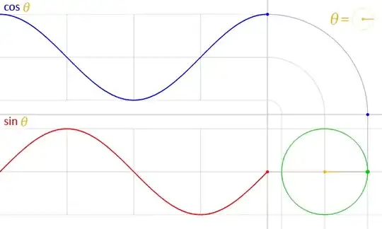

The concept of "negative frequency" deserves more attention. Real-world signals can be described in a number of ways to submit them to mathematical manipulation.
This video shows two phasors rotating at the same rate but in opposite directions.
(original source)
Each phasor represents a signal. Each signal comprises a "real" part mapped along the horizontal axis and an "imaginary" part mapped along the vertical axis. (We call the sum of the "real" and "imaginary" parts a "complex" number; there's really nothing complex about it, this is just a mathematical notation that keeps track of two related things in one "number.") The phasor rotating counter-clockwise expresses a positive frequency while the phasor rotating clockwise expresses a negative frequency.
The important feature of the video is that the imaginary parts of the two phasors always have opposite signs, while the real parts of the two phasors always have the same sign. When we sum the two real values and separately sum the two imaginary values, the real parts reinforce, while the imaginary parts cancel, always resulting in a real-valued signal - the kind we experience in the "real" world.
