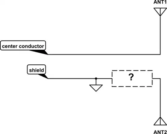

Good question! Properly operating, the coax shield is at ground potential. But a dipole needs both sides driven, ideally with voltages symmetrical around ground potential. So how can this work?
The first thing to realize is while the coax shield is at ground potential, it does not have zero current. Rather, the shield is at ground potential because it has equal in magnitude but opposite in direction currents to the center conductor. These opposite currents are associated with electromagnetic fields which cancel, resulting in no electromagnetic fields outside the shield. In other words, the shield is at ground potential if and only if there is zero common-mode current in the coax.
So what's required is something that will allow this shield current to pass through to the dipole, while allowing the potential at the shield and at the shield-fed side of the dipole to be different. So there must be something in the circuit across which this voltage can appear.
schematic
simulate this circuit – Schematic created using CircuitLab
That's the balun's job.

  • If antenna 1 is a quarter wave vertical, and antenna 2 is a large area of salt water or a solid metal plane on "good" ground, then "?" is (almost) nothing. – hotpaw2 Apr 26 '21 at 15:52
  • @hotpaw2 Very true, however the question asks about dipoles, whereas what you are describing is a monopole. – Phil Frost - W8II Apr 26 '21 at 19:41
