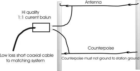

The "other half of the Long-Wire" is called a "Counter-Poise" which can be aprox. 10% to 15% of the long-wire length. My Counter-Poise is aprox. 23 feet long, and dangles away from my Long-Wire Antenna. ... Counter-Poise is NOT grounded to anything. Nada, Zilch, No Ground. W8JI writes "adding ground rods can decrease RF efficiency when an insulated counterpoise is used." I have verified this by experiment. Inside the Shack, at the Antenna Tuner, there is a solid earth ground for the all the equipment, including the ground of the Antenna Tuner. ...

The length doesn't matter much. If you make it the right length, then it will present a good match to your feedline, but if you have a tuner, and either place it near the antenna or use a low-loss feedline, then that doesn't matter.
It's also possible to get really unlucky and pick a wire length that's outside of your tuner's range. What these lengths are depend on your tuner and also the wire's surroundings and also the ground system. Odds are that most lengths are fine though, so the easiest solution is to pick a length based on something else (like, the room you have available) and if you get unlucky, roll the dice again.
Also, if the wire is too short, then it won't be a very effective radiator. If the wire is longer than half a wavelength, then making it longer doesn't make it any more effective. Making it shorter than half a wavelength doesn't suddenly stop making it working either, so if you don't have enough space to put up a full half-wavelength that's fine, too.
Fact is, if you can effectively couple RF current into something that's large relative to the wavelength and is a good conductor, you get an antenna. The bigger problem with end-fed antennas is subtle: it's actually only half the antenna. The ground is the other half, and I don't mean Earth. I mean whatever is attached to the other half of the feedline. If you are using a tuner that has just one wire coming out of it, then the other half is the tuner's chassis, and whatever is connected to it. If you are concerned about making a good antenna, my advice would be to learn more about end-fed antennas work, and interact with ground, before worrying about length.
