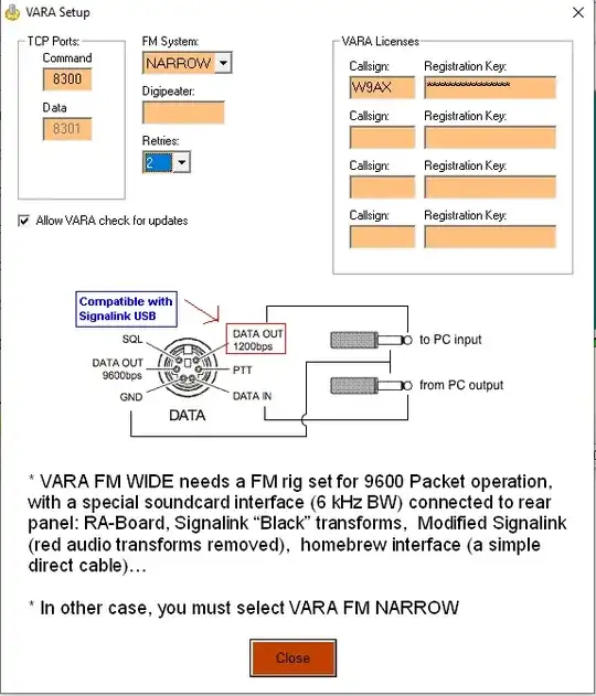

Vara FM configuration:
Settings -> VARA Setup...
  • Command: 8300
  • Data: 8301
  • FM System: Narrow
  • Digipeater:
  • Retries: 2
  • callsign and registration key also filled in

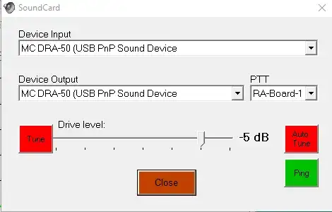

Settings -> SoundCard...
  • Device Input: DRA-50
  • Device Output: DRA-50
  • PTT: RA-Board
  • Drive level: -5 dB
Settings -> PTT...
  • PTT Via: RA-Board

VARA FM - Settings - VARA Setup VARA FM - Settings - SoundCard VARA FM - Settings - PTT
