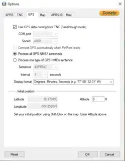

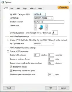

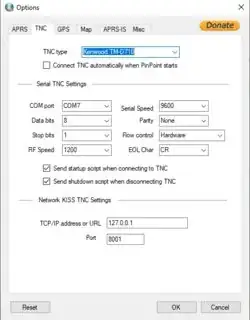

For this I use an RT Systems USB-K5G cable connected to the COM port on the back of the control head. On my laptop I'm running Pinpoint APRS v2.0.
Pinpoint APRS configuration
Pinpoint APRS - Options - APRS tab Pinpoint APRS - Options - TNC tab Pinpoint APRS - Options - GPS tab
Kenwood D710G settings
  • 601 INTERNAL TNC:
    • DATA BAND: B-BAND
    • DATA SPEED: 1200 bps
    • DCD SENSE: D or RxD BAND
    • TX DELAY: 200 ms
  • 602 GPS PORT:
    • BAUD RATE: 9600 bps
    • OUTPUT: WAYPOINT
  • 603 WAYPOINT:
    • FORMAT: KENWOOD
    • NAME: 9-CHAR
    • OUTPUT: ALL
  • 604 COM PORT:
    • OUTPUT: ON
