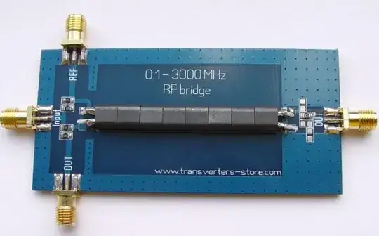

However, I recently purchased a low-cost Return Loss Bridge from a vendor in the Ukraine (see image below) and I was wondering if I could press it into action to help measure amplifiers.

It's an old thread, so I can't ask the OP for clarification but I'm hoping someone more knowledgeable than I am can parse this comment and help me understand how the RLB is helping in this situation.
Some of the questions I would have are:
What does the layout look like? What are the connections? When he says: "attenuate the output" does he mean the output of the VNA (i.e., CH0) or the amp? What exactly is the "return port" of the RLB?
What exactly can you measure with this technique? Can you measure gain, for example?
Is this external RLB method superior to using the attenuation method? Why so?

The quoted poster in the linked thread is suggesting to use an external reflection bridge but it is confusing why. The NanoVNA has a built-in directional coupler on Ch0 with maximum 0dbm output (and input), and 0dbm maximum input on Ch1 for S21 measurements. With these known limits, combined with the expected characteristics of your LNA, you can simply add the appropriate attenuators to the Ch0 and Ch1 connectors and dispense with the external reflection bridge and the extra processes and pitfalls required to calibrate the unknown thru characteristics of the bridge altogether.
Regarding the functional use of the reflection bridge, this is a topic not thoroughly capable of being answered here as it is a manual-filling topic since the device requires various connection patterns during the process (calibration, bridge insertion loss measurement, reference calibration, DUT measurement, etc).
Yes, you can measure gain, but only after fully characterizing the bridge (unknown through) and with it comes additional pitfalls. It is a good exercise to attempt, for educational purposes, but it is certainly a process and not a simple "connect like this and measure" answer.
The reflection bridge measurement method will not offer superior results than using the built-in directional coupler of the NanoVNA for characterizing your simple LNA. However, a reflection bridge can offer additional features that a simple directional coupler does not. For example, with a theoretically perfect reflection bridge, you can characterize devices designed for any impedance such as 75-ohm, or dynamic devices that have changing impedance via feedback through the reference port on the bridge, but these are rare cases in the amateur RF hobby and if you require such measurements, you likely require much higher sensitivity or frequency range than the NanoVNA can provide (e.g. in designing a PCIe Gen4 retimer, PCIe Bifurcation Switch etc).
