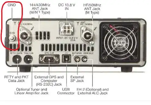

Do modern radios require grounding to be used safely? All I am concerned about is not getting electrocuted when I attempt to use the radio. I'm not concerned with RFI or Lightning safety at this point in time.
The power supply apparently has a ground connection as well, even though it uses a standard AC 3rd prong ground power cable. Is this one different or required as well?

    The *standard AC 3rd prong ground power cable* does not go directly into the radio... the radio is fed by the *13.8V DC* connector - which does not have an earth. – Andrew M0YMA Aug 25 '21 at 06:23

In the circumstances that you talk about with the help of the picture, the power supply is grounded through the mains power feed. The power supply can be considered safe because if a live wire comes adrift for example inside the power supply and touches the chassis, the protection circuit , often a fuse, should blow, avoiding any risk of electrocution.
Consider the case where your radio is connected to that power supply and the negative rail is connected to the power supply ground internally. The equipment would be safe. Because like in the previous case, if a live wire comes adrift and contacts the chassis the protective fuse will blow. Negligible possibility of electrocution.
Consider another case, where this time the negative rail is not connected to the power supply ground the chassis of the radio will not be grounded. This is still safe since there is no high voltage made available to the radio that may contact the casing of the radio. In any case, if a live wire comes adrift and touches the chassis, the fuse will blow.
For completeness, the question might therefore be asked - why are there grounds lugs on the power supply and the radio? This is a wholly different area but please note that in some countries with some kinds of premises wiring it can actually be unsafe to connect this lug, or any part of any antenna, to an external ground such as a ground rod outside. But this is outside the scope of your question as are all RF noise and lightning concerns.

The way I look at it, a well-constructed amateur station can have as many as three ground systems (which should be connected together): an electrical safety ground, an RF ground, and a lightning ground. When you talk about grounding something in a station, it helps to specify what the ground is for, or what hazard you're trying to protect against.
Regarding the electrical safety ground, most radios have the negative side of the DC power input connected to the chassis, which is also what the ground connector on the back panel is connected to. A typical DC power supply has the chassis connected to the negative side of the output, and also to the safety ground pin of the electrical outlet (the green wire in the US; the green-and-yellow striped wire in Europe, I believe). So if your wall outlet is wired according to current code, then the chassis of your radio is already connected to the safety ground pin of the outlet. If that's so, then you should have no need to worry about electrocution from the electrical mains, even with nothing connected to the ground connector on the back panel.
If your antenna is unbalanced then some of your transmit power can be sent back to the transmitter through the coax braid. This is what is known as "RF in the shack". I've heard of extreme cases of operators getting "stung" by RF when touching the radio while transmitting. These days most people advise a good balun as the best way to solve such problems, which is supposed to present a balanced load to the transmitter even when the antenna is unbalanced, rather than an RF ground connection, which is difficult to arrange in many situations.
The reason that there is a separate ground connector on the back panel of the radio is because many operators want a convenient way to connect their radios to RF ground, as a best practice that was often promoted in decades past, and to reduce "RF in the shack" problems. Or they want a connection to a lightning ground system, to better protect the radio from a nearby lightning strike.
To sum up, if you have a properly-wired outlet, then you shouldn't need to worry about electrocution from the electrical mains. If you have a balanced antenna or a decent balun, then you shouldn't have to worry about getting zapped by RF in the shack. The purpose of the ground connector on the back panel is not to keep you from being electrocuted, but rather to connect the radio to an RF ground or a lightning ground.
