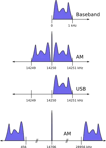

An image might help.
You begin with your baseband signal, some voice going from (almost) 0 Hz up to 1 kHz.
Next, when this is AM modulated at 14.250 MHz, we get a carrier at that frequency, then two sidebands above and below it that are just like the baseband signal.
But, this is USB, so the carrier and the lower sideband have been removed (somehow) by the transmitter. So really, all we have is the baseband signal, shifted up by 14.250 MHz. Our goal is now to shift it back down. However, remember where the carrier was. Where the carrier was corresponds to what we want to eventually be 0 Hz when we demodulate the signal.
So, you mix this with an LO at 14.706 MHz. You can think of this as AM again, only the sidebands are very much more spread apart. The result is the last figure.
The "carrier" frequency of the signal, the part that we eventually want to land at 0 Hz, is now at
$$ | f_1 - f_2 | = |14250 - 14706| = 456 \mathrm{kHz} $$
The upper end, which eventually should end up at 1 kHz, is at
$$ | f_1 - f_2 | = |14251 - 14706| = 455 \mathrm{kHz} $$
Usually at this point, after going through the IF filters, you would mix again with a 456 kHz BFO, and that will take the lower sideband you generated in the first mixing stage and convert it back down to baseband.
The audio bandwidth (you specified 1 kHz in your example) isn't really relevant, except to the filtering you do. If the audio bandwidth had been 4 kHz, then the BFO would still be at 456 kHz. The only difference is that the image you generated in the first mixing step would extend farther down, and you'd want a wider filter to accommodate that.
