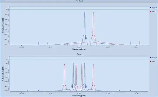

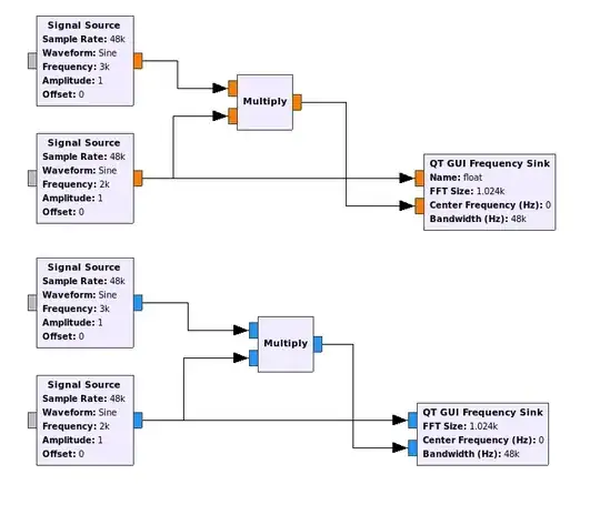

Construct 2 similar flow graph in Gnuradio,just different with data type.
complex type data has a correct result.But float type data output 3 peaks,I don't understand.
What cause multiply has difference result between float and complex signal?

That's just the math behind it – everything is alright with these results!
You need to write down the formula of the real-valued $\sin(t)$ in terms of $e^{j2\pi t}$ and $e^{-j2\pi t}$, and you'll see that, as shown in your plots, the real-valued harmonic oscillations have a positive and a negative frequency component – so multiplying two of these yields four components.
This isn't really a programming or even a DSP problem – you just have to be precise with the math.

This is a consequence of what was discussed in your previous question, that any real-valued function like $\sin(\omega t)$ consists of both positive and negative frequencies.

In your example with complex-valued blocks, you begin with a complex exponential which has a signal at just one frequency. Then you multiply that by another complex exponential, leaving you with still just one frequency, but shifted.
In your example with real-valued blocks, your first sinusoid begins with signals at two frequencies. Again, any real-valued function must have both positive and negative frequencies. When you multiply that by another sinusoid, you are both shifting those two frequencies you started with up (with the positive frequency) and down (with the negative frequency) present in your second signal block. The end result is the two frequencies are split into four.

If I understand your question correctly, the issue is that you have one graph producing a complex output of an FFT and the other producing a floating point output from an FFT.
When you produce an FFT from complex data using a floating point output, you will find that the signal is reflected across the y axis at zero. This is because the floating point version does not capture the phase angles since they are in the complex plane.

A real-valued multiply is the same as an AM modulation, where the result includes both upper and lower sidebands. (Similar to the spectrum of an AM radio station on an SDR waterfall.)
A complex-valued multiply is more like an SSB modulation (plus carrier, depending on modulator depth and offset). So you only get one sideband, upper sideband if the modulator is a positive complex exponential, lower side-band if the modulator is a negative exponential.
