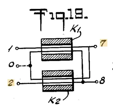

The most commonly encountered application of this idea is the 4:1 Guanella balun, described in the patent:
By the combination of two or more two-wire lines or devices of the type according to the invention, it is possible to secure a transformation ratio differing from one, as well be described in greater detail hereafter. A an example, since with a proper design of the inductance of the coil DR, FIG. 14, the latter may be practically neglected, it is possible, for instance, to connect the input of a pair of two-wire transformers or devices in series and to connect their outputs in parallel, as shown in FIG. 19. In the latter, the common input junction point will be at a potential intermediate between the potentials of the input terminals 1 and 2 and, if desired, may be connected to a special zero or neutral terminal 0, as indicated by the dotted line in the drawing. A combination of a pair of two-wire devices according to FIG. 19 results in a voltage transformation ratio of 2:1, corresponding to an impedance transformation ratio of 4:1. In an analogous manner, it is possible to connect the inputs in parallel and to connect the output in series, as will be readily understood.
However, the patent is not limited to just 4:1 transformations, but rather any series and/or parallel combination of transmission lines wound on ferrite cores.
