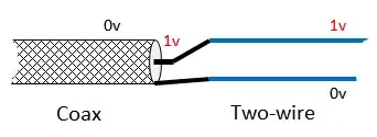

The point at which you connect the coax to the two-wire line is a bit like a dipole feedpoint, with about half the voltage applied to it. This is why:
  1. The voltages on the lines look like this at the junction. (Remember when you zoom in to a region much smaller than a wavelength, there's no RF magic; all the usual rules of circuits apply as normal):

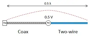

  2. Coax is "shielded" so the outside world sees the voltage on the (outside of) the outer conductor. On a two wire line, the fields are mostly constrained to an area about double the spacing of the lines. Because the spacing is << wavelength, from far away the two wire line looks like a single wire with the average voltage on it. Zooming out:
  3. From far away now, you have a wire with a half voltage source in the centre. One side is the outer of the coax, the other is the two-wire line, just the common mode current. How much this radiates depends on the length of the parts of the wire. The case that radiates the most would be a (physical) quarter-wave of coax and a quarter-wave of two-wire line. From far away now:
    So you have a dipole antenna formed by the whole coax on one side and the pair of wires on the other. The dipole currents are the common mode currents.
I'm ignoring some more subtle effects. For example the dipole radiation resistance forms a load which is connected at the feedpoint, which might interact with the voltages on the lines. So the 0.5 V might change when this is considered.

  • Interesting explanation. It somehow feels so intuitively explained that it is hard to believe it can be true. So the left part of the 0.5V sinusoidal voltage source is not connected to the shield of the coax, how do you then explain that the coax shield is part of this dipole? – rubund Nov 04 '21 at 20:15
  • No, perhaps my diagram isn't clear. From far away, a piece of coax just looks like a piece of wire. It's shown in black. I'll tweak it. – tomnexus Nov 04 '21 at 23:20
  • My point is that only the 0V side of the ladder line is connected to the shield of the coax. How can the 0.5V source then generate currents (common mode) in the coax shield? – rubund Nov 05 '21 at 08:21
