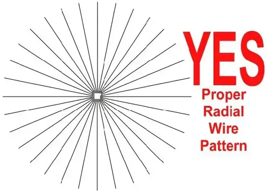

The most recent manual that was written with help from DX Engineering contradicts earlier versions of the manual regarding its advice for limited-space antenna installations. The manual now suggests that not bending the radials is the way to go. The manual also says that many short radials are better than a few long ones.
image capture from 6-BTV manual, showing various arrangements of bent radials with red X marks through them and "NO" in red
image capture from 6-BTV manual, showing evenly-spaced straight radials and "YES" in red There are many questions tagged with more information. I've linked to a couple.

    In the manual of the Hustler http://www.radiomanual.info/schemi/ACC_antenna/Hustler_4-BTV_5-BTV_6-BTV_new_version_user.pdf on page 13 this kind of inductive radial is disadvised. The lowest inductance in lossy ground is obtained from straight line radials, eventually splicing in more lines at a distance from the center point, to have maximum coupling with the soil. Bending radials results in higher losses. –  Nov 28 '21 at 14:44
  • It appears that [DX Engineering wrote its own manual](http://static.dxengineering.com/pdf/btv-install-guide-rev0c.pdf) [PDF], superior to the Hustler manual. On pages 11-15 or so, detail radial considerations. I was going to write an answer using that (sigh) but someone else will have to. [Source](https://forums.qrz.com/index.php?threads/radials-for-hustler-6btv-multiband-trap-vertical.506746/#post-3708262) – Mike Waters Dec 06 '21 at 23:32

I have 64 radials on my Hustler 6 band antenna. I live in the central US and have made voice contacts from Japan to Brazil to Germany on 100 watts. I recommend at least 32 radials if you can manage it. My radials are 33 feet and 66 feet.
