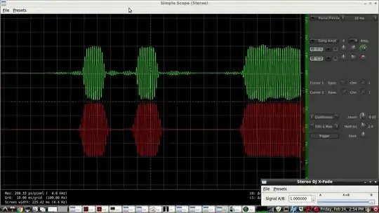

Personally I wouldn't worry much about chirp (frequency pulling), unless it's really bad. It's not hard to copy, for a human anyway. It warms my heart whenever I work someone with a chirpy homebrew transmitter.
Key clicks, what you're calling splatter, is another matter entirely. You'll need some sort of circuit to shape your keying envelope or your key clicks will occupy an incredible bandwidth, possibly only limited to the bandwidth of your bandpass filter. 1 W is quite low power of course, but key clicks unfortunately are easily heard many kilohertz away (for egregious cases). And operators like to tune around to discover who has such an awful signal.
(Key clicks used to be a dirty Morse code contesting trick to keep one's frequency clear. No other station wants to be near in frequency to a loud clicky signal, because it's hard to copy when someone else's clicks are overlaid on the signal one is trying to copy. Certain well-known commercially-made transmitters were famous for making bad key clicks.)
Here's what a non-clicking signal looks like on an oscilloscope at audio frequencies (simulated, apparently).
An oscilloscope trace of a Morse code signal with no key clicks.  Two dits and a dah are shown, and the amplitude of all slowly grow and slowly decay.

    Any thoughts or references on how to minimize the clicks? I think this was a key part of what I was concerned about. – Toby Eggitt Nov 25 '21 at 02:03
    Yup, this answer, while very helpful doesn't address the click part of the OQ. However, I agree with you about the chirps. :) I have seen some key click suppression circuits in some older east (ARRL) and west coast (E&E; later Bill Orr) handbooks. They are for tubes, but IIRC they should be relevant regardless. – Mike Waters Nov 26 '21 at 19:54
  • At any rate, this answer shows what you should check for using an oscilloscope. It doesn't have to be an expensive one. – Mike Waters Nov 26 '21 at 19:56
  • Indeed it does. I have a scope, so we're good there. – Toby Eggitt Nov 26 '21 at 23:54
