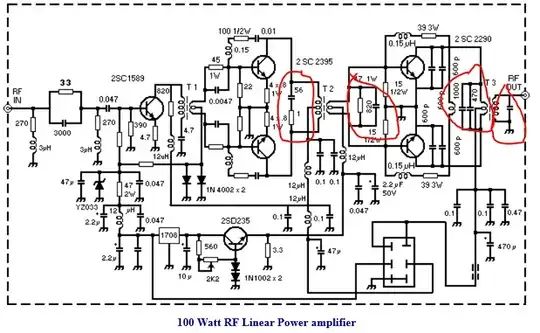

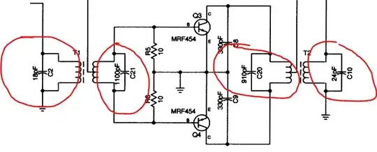

I keep finding RF push-pull power amplifier designs specified with a small(-ish) capacitor across the primary (or secondary) windings of the coupling transformers. Here's an example:
This is one example with capacitors across all windings, but I find them across the primary of the output transformer (the winding connected to the collector/drain of the transistors) most often.
Here's another example, this one with damping resistors either in series or parallel:
I'm assuming that this forms a resonant circuit of some kind and I'm assuming that they play a role in filtering harmonics, but I'm just not sure.
So, here are my questions:
  1. What is the benefit of having these capacitors (in the context of a PA)?
  2. Are they more effective in amplifiers cut for a particular band or are they also useful in broadband transceivers?
  3. How do you calculate what the value should be?

If these are broadband (toroidal, coupling ~ 1.0) transformers, then the capacitors in series with the resistor can be used to dampen the resonance that takes place at the edge of the band (higher frequency side).
One can see a peak in the transfer curve in the below picture.
So, the capacitor with the serial resistor (left 1 Ohm + 56 pF) can damp the peak at the highest frequency.

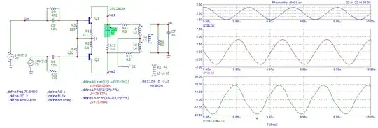

I have tried to simulate a part of this PA, where the serial capacitor with resistance is present (not the same value). I found also something interesting despite the difficulty of simulating ... (AC Analysis was weird).
Inserting this serial C+R makes the output (Vce1 to Vce2) "waveform" better. Perhaps also a "side" effect.
Here are the two pictures (Transient analysis). Frequency test 75 MHz with 2SC2413 transistors. (2SC2395 not in database).
Antonio51
