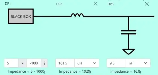

This is how a parallel Capacitor works:
  • Guessing the antenna is 5-j1000 Ohms (1/10 wavelength ?)
  • Frequency 1 MHz, with a span of 1 kHz
  • Series inductor of 161.5 uH which is +j1020 ohms slightly too big for resonance
  • Parallel capacitor of 9.5 nF raises the impedance to exactly 50.
Using the amazing smith chart at https://www.will-kelsey.com/smith_chart/
Circuit

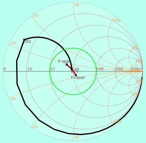

This is the result:

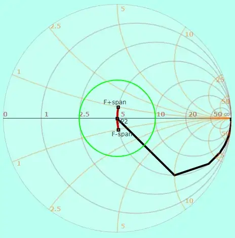

Of course it's quite narrow band, but this is mainly because of the antenna+inductor circuit Q, not the matching network. Here is the Smith chart when I use the perfect +j1000 inductor in series, plotted at 5 ohms (equivalent to using a perfect 5:50 impedance transformer). See the bandwidth is about the same (~2 kHz at 2:1 SWR, but this is a lossless inductor).
Play with the Smith chart online to see the impact of different solutions. For small changes in frequency I think you'll find a fixed C and variable L will be good enough. For large changes like going from 500 kHz to 1.8 MHz you'll need different C too.
