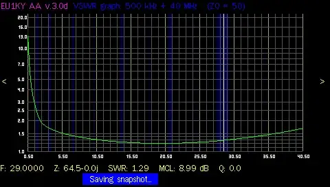

For the second one, I used FT240-43 ferrite core, as shown in the article by Rudy, N6DOZ. This transformer is wideband and works on 3-30 MHz. Although when loaded to 2450 Ohm non-inductive load (metal-oxide or metal-film resistor) instead of 50 Ohm we see a slightly inductive load:

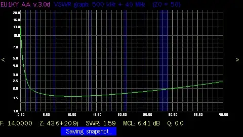

From what I know this is because the large secondary winding works as an inductance in series with the load. This inductance can be compensated by placing a capacitor in parallel to the primary winding of the transformer. Here is the effect of placing a 57 pF capacitor (47 pF || 10 pF):

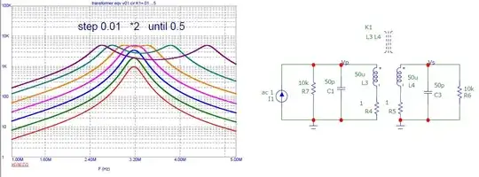

Air-core "transformer" is composed of 2 inductors "TUNED" with a magnetic coupling slightly less than 1. The resulting effect is a narrow bandwith "transformer".
Example with coupling coefficient of 0.01 to 0.5

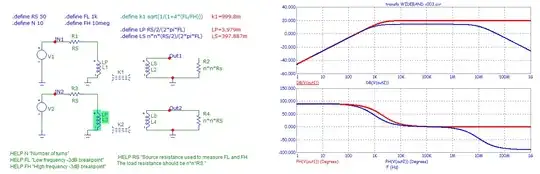

Ferrite-core "transformer" is "same" thing except that magnetic coupling is quasi perfect. So it really has the behavior of a transformer with large bandwith.
I have made a simulation in 2 cases (resistor ad hoc on output, open output, same K ... k1=k2).
I think it would be more clear now. See that "coupling" K is quasi "1".

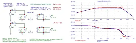

And here what happen when capacitors are also used.
