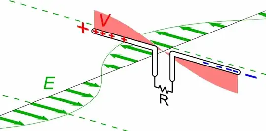

It does indeed seem tricky to find a clear illustration of this via Google. Wikipedia does have a clear illustration of how the electric field interacts with a half-wave dipole. It shows how the electric field is aligned with the dipole elements. This picture shows horizontal polarisation.
Animation of half-wave dipole in an AC electric field
Source: Wikipedia
A Yagi-Uda antenna uses a half-wave dipole as the driven element. The directors and reflector are in line with the driven element.

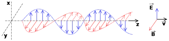

The polarisation of a radio wave is always specified as the polarisation of the electric field component of the wave. A radio wave also has a magnetic field component which is at 90° to the electric field (omitted in the picture above). So a vertically polarised radio wave will also have a horizontal magnetic field.
Graph of EM wave Source: Wikipedia
In the picture above $ \vec {\mathrm{E}} $ represents the (vertical) electric field, $ \vec {\mathrm{B}} $ represents the (horizontal) magnetic field and z or $ \vec {\mathrm{V}} $ represent the direction of propagation of the radio wave (travelling towards the right of the picture). The arrows over the variables indicate they are vector quantities - that is, they have both a magnitude, shown for $ \vec {\mathrm{E}} $ and $ \vec {\mathrm{B}} $ by the length of an arrow, and a direction, shown by the direction of the arrow.
(Note that this diagram is a graph of the electric and magnetic field strengths and directions at points along the direction of propagation (the z axis) shown in the picture. If this was visible light we would call this a ray. It is not a picture of what a radio wave would look like if the fields were visible.)
