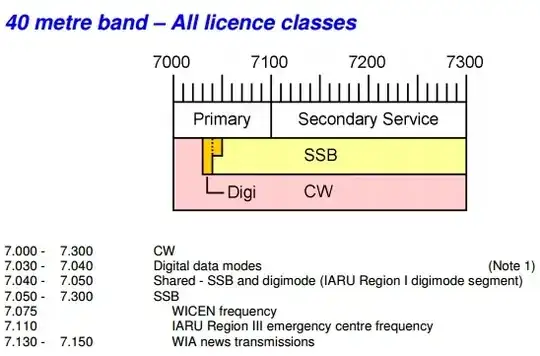

Try to find the allocated amateur radio band plans for your country. You will notice that there are reserved sections of the band plan that are for CW only. Usually they are in the first few kHz (i.e. lowest frequency) for the band you're interested in. For instance, in Australia the CW portions for common HF bands are:
band  ~freq   CW portion
160m  1.8MHz   1810 -  1840
80m   3.5MHz   3500 -  3535
40m     7MHz   7000 -  7030
20m    14MHz  14000 - 14070
15m    21MHz  21000 - 21070
10m    28MHz  28000 - 28200
(These could all differ a bit from country to country)
Australian band plan for 40 metre band
(Australian band plan for 40 metre band) Source: http://www.wia.org.au/
Then, using the websdr page as AndrejaKo suggested you should be able to tune in to some CW and hear live what is being transmitted.
