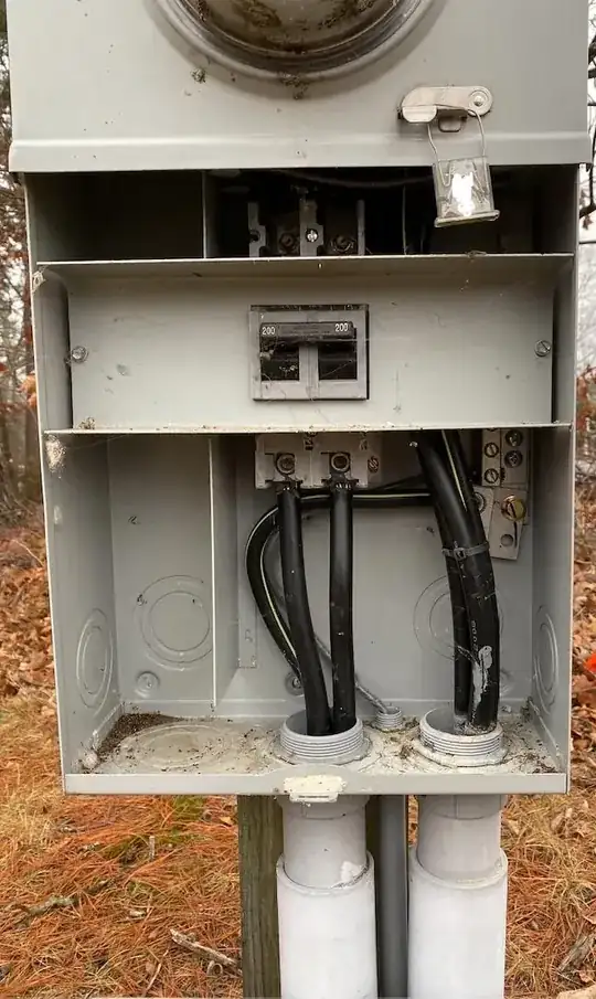

Meter
  • My meter is on a post at the street ~300ft from my house
  • The meter box has a section that is accessible to me that contains a 200 amp circuit breaker
  • The meter is grounded via ground rods located in the ground at the base of the meter
  • The ground wire in the meter box is bonded to the neutral in this box
  • 3 wires leave the meter box in underground PVC conduit: 2 hots + 1 neutral (no ground wire)

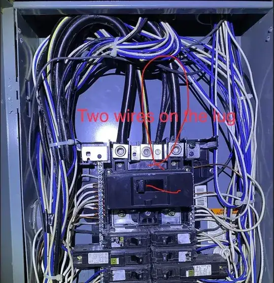

  • This panel has a green screw which I think bonds the neutral bus with the panel box and ground lug that I think is normally used for the connection to earth (ground rods)
  • Two wires are connected to the ground lug on this panel: 1. My cold water pipe bond (copper service pipe + copper pipes in the house), 2. A wire that goes to a ground lug on my generator automatic transfer switch panel

  • Can I just install my new ground rods + wire them to anywhere on my neutral bus? Or do I need to install a separate ground bus in my main panel + move my water bond & generator ground to it? Perhaps the ground rods could be connected to the same clamp that my cable/phone service are connected to (I think this may be referred to as an inter system bus terminal - IBT?)
  • The ground lug on my main panel having TWO large wires on it looks fishy to me. I'm wondering if this isn't code to have two.

Meter by the street ~300 feet from the house Meter up by the street
Main panel inside the house Main Panel

    Grounds that are far away (>100') don't count for lightning. So I'd say don't worry about the meter, it can take its chances. Make sure you have good ground bonding between house earth, coax shield and the actual earth, close to your shack. Without violating code. – tomnexus Jan 04 '22 at 19:26

  • Yeah I gotcha. I think that central point is the ground lug in my main panel (circled in red in the photo of my main panel). I don't see a way to effectively do that since there are two large wires (cold water and generator bonds) connected there. I'm wondering if I need some type of additional terminal added to my panel that I can move those bonds to, creating a central point that supports more wires. That would take care of my existing bonds and support a new one for the antenna ground rods. I'm going to reach out to the electrical inspector in my town. Thanks for all the replies! – kr4sh Jan 04 '22 at 07:41
    Rather than connect to the ground lug on the main panel, it might be better to try to connect to the thing that the wire on the ground lug connects to. – user10489 Jan 04 '22 at 12:11
