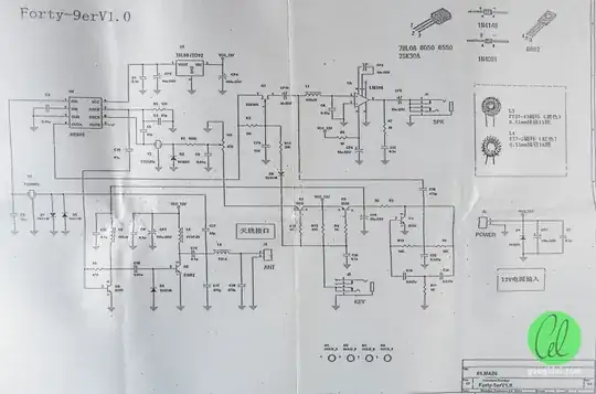

For reference, here's the schematic to a "Forty-9er": enter image description here

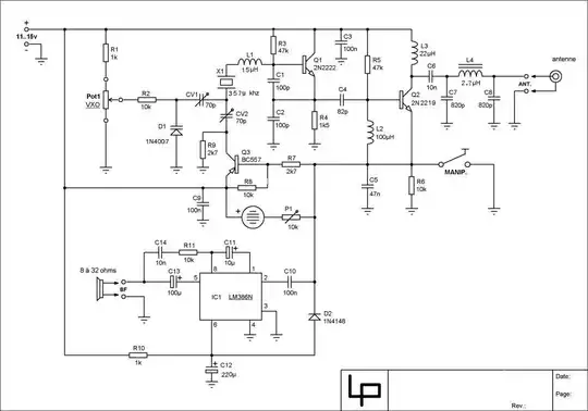

here's a "Pixie" schematic: enter image description here

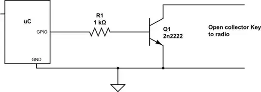

Keying to ground is simple enough with a single transistor and a resistor. This will work at 3.3 or 5 volts.
schematic
simulate this circuit – Schematic created using CircuitLab
The Pixie seems to put all the PA current through the key, so you might use a smaller resistor, 220 ohms, to guarantee the transistor is saturated.
You could also use a MOSFET if you have a logic-level one in your junk box, the circuit is the same but no resistor required.

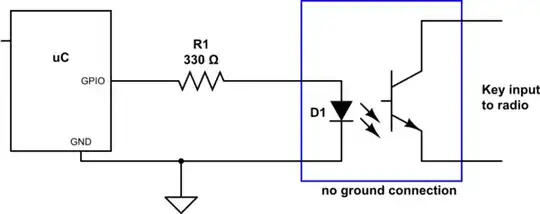

A small capacitor might reduce the amount of RF noise from the micro leaking into the radio circuit, but that will be a problem even just putting them anywhere near each other. Better might be to use an opto-isolator. For the 49-er you could probably use it with no external driver:
schematic
Choose an isolator with a photo-transistor, not a photo-diode, and for the Pixie, you need to check whether its maximum current and "on" resistance will be good enough.

You could comfortably switch the Pixie directly, because the voltage on the base of Q3 when the key is open would be only 3.4 V when the supply voltage is 16 V. That voltage is set by the R5/R6 voltage divider. The current should be much less than the 20 mA (if my memory serves me correctly) that the microcontroller pin is capable of sourcing or sinking.
The Forty-9er has a full 12 V on the key, so you'd want a transistor for that. If it were my project I'd throw in a transistor for a Pixie anyway, in the hope that an accidental voltage transient would fry the transistor instead of the microcontroller.

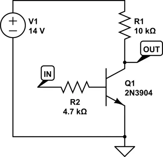

Here's how to do it with an NPN. (This is my first time inserting a schematic, and I don't know how to make it smaller, sorry; if anyone wants to edit my question to make it smaller, please go ahead.) Any old generic switching transistor such as a 2N2222 or a 2N3904 would work. (I miss being able to buy them at Radio Shack...) R1 limits the current through the transistor. R2 limits the current through the base of the transistor.
schematic

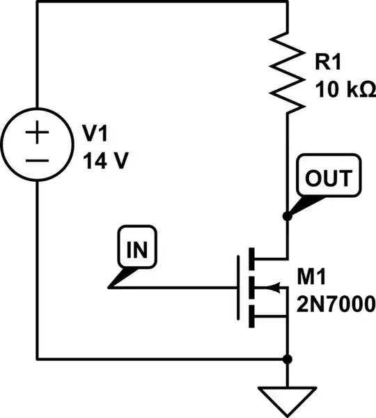

Doing it with a MOSFET would also be simple:
schematic
