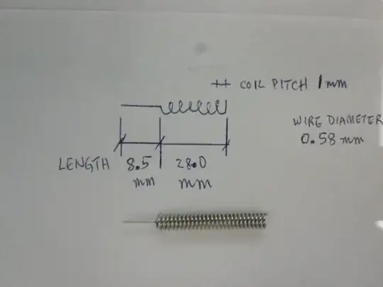

I refers to these type of coil antenna as in lower right of this photo as originally designed for walkie talkie. 70cm band is about 10% off the walkie talkie freq. Presumably, one can start by cutting a few percent length and start tuning from there.
EDIT: Here is dimension and photo of actual antenna on hand. The long 'end' (end of 8.5mm segment) is the feeding point to be soldered to PCB. The end of 28.0mm segment is not-connected. The antenna coil will be 'vertically mounted' on copper pcb acting as ground plane. The ground plane will only be 100mm, smaller than the ideal 0.25 wavelength, due to size restriction.

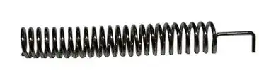

EDIT2: @K7PEH Feed point is the end of the straight-segment (leftmost in photo). Wire diameter 0.58mm. Coil diameter is 4.23mm. Coil 27 turns. Total wire length 359mm. Appreciate if you may enter data, save screen dump step-by-step in a words file and email me the work flow file so that I can learn. Specifically, how is the antenna specification entered as 'segments' into the program.

  • @JWilliams -- if you are still interested in answers, you could run a computation with NEC2/NEC4 to produce the gain, losses, impedance match for a given frequency. I could run the solution for you if you can give detailed specific sizing information on the antenna (rubber ducky) and coil. Or, is the coil itself the entire antenna? If there is a conductor in the antenna in addition to the coil I would need to know sizing, how it is arranged (coil at base, middle, etc.). I can't get to doing this until December 2nd or so as I am out of town over Thanksgiving holidays. – K7PEH Nov 26 '14 at 03:29
  • @K7PEH. Thanks for the calculation offer. I edited to include diagram and photo of one antenna on hand. I am not 100% sure if that ant is 433MHz but I can re-make the coil to any size after knowing calculation method. Please do a demo calculation, showing me the step involved and where to download a free version of the software, so that I can perform the calculation myself with modified design, etc. The coil is the whole antenna as shown in the photo of a factory-made walkie talkie. I plan to mount the antenna vertically on ground plane PCB, may be smaller than 0.25 wavelength. – EEd Nov 27 '14 at 21:00
  • @JWilliams -- which end is the feed point? Also, you specified wire diameter. Is that the wire diameter itself or is that the coil diameter. I need both values and I suspect the 0.58 mm is wire diameter. The pitch is not important. I actually need the total number of turns and the length of the turns which you have given. I would rather you counted the turns rather than give pitch size. And, there is a FREE version of EZNEC that has NEC2 built in and available at http://www.eznec.com – K7PEH Nov 28 '14 at 06:12
  • The two photos of the antenna look different? Are these the same antenna? – K7PEH Nov 28 '14 at 14:38
  • OK on feed point and other data. When I get into the solution (hopefully) I will post the information I get. I do foresee a potential problem in the modeling. There is numerical problem in NEC2/NEC4 dealing with tightly wound coils (not designed for that) and so I am not sure if this coil is in the range of the problems or not. Only way to see is to try. – K7PEH Nov 28 '14 at 14:45
  • Antenna is described in geometry model composed of wire conductors (in this case). Most wires are straight line but the coil here will be modeled using the helix geometry model segment. Actually, curved lines can be modeled too but the helix model type is specially designed for this type of thing. – K7PEH Nov 28 '14 at 14:47

I volunteered to run the NEC2 calculation for this antenna and after the OP provided more details I started doing back of the envelop computations since I am away from my main computer for a few days (where I have NEC2/NEC4 and my Mathematica solution modules). I did a simple reactance calculation of the coil itself at the designated frequency of 462 MHz which is open for FRS/GMRS operations that I think is associated with the rubber ducky antenna of the HT.
The inductance is approximately $0.43\,\mu H$ and the resulting inductive reactance $X_L$ is: $$ X_L = 2\,\pi \, f\, L = 2\times 3.14\times 462\times0.43 = 1248\, ohms\qquad \text{(rounded)} $$ This rather large impedance means that this rubber-ducky (for it to work at all) has high capacitive coupling to the HT and even probably to the person holding it which naturally form part of the antenna system.
Therefore, I posted some questions on NEC2 distribution list and one answer (from the creator of EZNEC, who is a Guru/Wizard with NEC2 and NEC4) provided these comments (quoted directly from his e-mail):
It's not practical to model with NEC-2 for several reasons:
  1. The "ducky" is only a part of the antenna system. At least as important, and likely more important, is the person holding the radio which can have a major impact on the pattern. Whatever the current flowing into the base of the "ducky", an equal amount of current flows along the outside of the radio and the person holding it. This current causes radiation just as the current on the "ducky" does, but from a much larger "antenna".
  2. My experience is that modeling an inductively loaded antenna as a wire with one or more ideal inductive loads doesn't provide accurate results. I believe this is because the current changes significantly from one end of the actual loading inductor to the other, while currents are the same at the ends of idealized loads. Even using multiple loads doesn't do as well as modeling the actual inductor as a helix.
  3. NEC-2 requires that wires be spaced at least several diameters apart. A typical "ducky" helix has turns spacing closer than this, making modeling the inductor portion of the antenna as a helix questionable.
  4. NEC-2 doesn't take into account proximity effect, which might be significant with closely spaced helix turns. Presuming you're trying to evaluate the efficiency of the "ducky", this means that the efficiency shown by the model will be overly optimistic even if you use realistic values for wire resistivity.
  5. NEC-2 has no way to account for the dielectric surrounding a "ducky". This will alter the resonance of the antenna in a way not predicted by the program.
Sorry, there are just some things that can't be practically modeled with NEC-2. This is one of them.
End of Quote.
So, sorry to say that when I get back home I will probably not try to model this antenna as I volunteered to do. Hopefully though, there is sufficient content in this answer to give the OP more information to make judgements or decisions regarding the rubber-ducky antenna.
