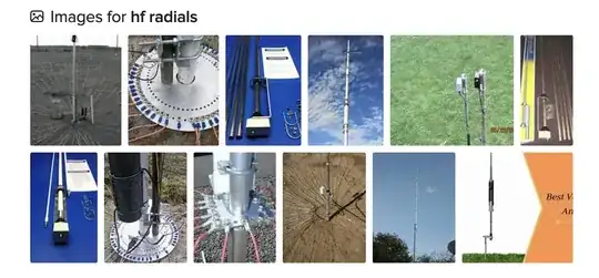

It's a bit counter-intuitive that for an HF vertical antenna (such as a quarter wave monopole) the best advice is to put as many radials and as close to the proper length as possible.
Sample image search results showing dozens of radials out across the fields around vertical antennas

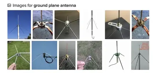

The typical VHF/UHF "ground plane" antenna works on basically the same principle: a quarter wave monopole plus an artificial ground plane. But in the case of these builds, usually only four radials are ever used!
Sample image search results showing five-element antennas usually constructed around coaxial sockets
Usually the allowable "gap" when converting a theoretical flat surface to a works-in-practice build (e.g. discones and parabolic meshes and such) gets smaller in proportion to the wavelength. Yet here it's just the opposite — for a 160m vertical monopole I'd still want a zillion radials, yet for a 23cm vertical monopole somehow only one every 90º is totally fine?

That's why only 2 or 4 radials work for elevated “ground plane” antennas
So I think that this ends up being a very practical matter.
Because VHF/UHF ground plane antennas are small, they are easily (and commonly) mounted a large number of wavelengths above the earth's soil they can get away with only two radials. (Why we don't just build them as 2-element dipoles instead of 5-element "ground planes" is left as an exercise ;-)
Whereas HF monopoles tend to be large and difficult to support (and add radials to) unless they are installed on the ground itself — but that earth which is so useful mechanically ends up being a liability electrically!

  • Yup. *Elevated* HF verticals frequently have a small number of resonant radials, but when they're at ground height you need many more of them to reduce loss. – hobbs - KC2G May 14 '22 at 02:30
