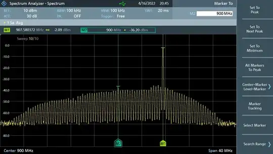

The r-f spectrum of a double-sideband "AM" transmitter includes the carrier wave and the upper and lower sidebands produced by the modulation of that transmitter.
It is being assumed in this question that the amplitude of the carrier itself must vary with modulation. However when an AM transmitter is optimally adjusted, the amplitude of the carrier remains very nearly constant with modulation.
When the total modulated spectrum is evaluated in the frequency domain, it can be seen that the carrier amplitude remains ~constant as long as the transmitter is not "overmodulated," and that the r-f spectra occupied by the upper and lower sidebands vary only as functions of the frequency spectrum of the audio waveform modulating the transmitter — not the amplitudes of those r-f sidebands.
The clip below published in a broadcast trade journal shows the frequency domain spectrum of an AM transmitter, and discusses this in more detail.
Richard Fry
  • 2,922
