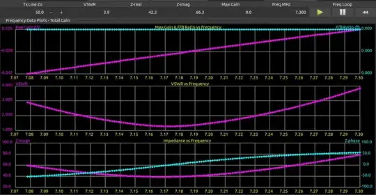

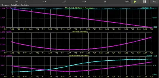

I've been working with Xnec2c to model a 40 meter vertical antenna I want to build for field QRP. This antenna is short at 25 feet and uses a 1:1 unun at the base with 4 radials.
The model has the load placed 1/4 of the way up (~6 feet). The model load is 35uH and 17pF. I've used toriods.info to pick an FT37-43 to have 10 turns. The web app reports that the inductor will have 12 pF. So I'm adding a trimmer cap in series.
My understanding is that b/c the antenna length is not close to being resonant, the Q must be quite narrow. I recall from my basic LRC theory, that R can widen the Q. So I added 20 Ohm to the model and sure enough the SWR flattens somewhat.
It seems like a really bad idea to add a resistor to an antenna in this way. The gain without the resistor is ~2.9 dBi. That's almost half power.
Is using a resistor like this done ?
First plot is with resistor and the second without.

With 20 Ohm Resistor No Resistor

It's reasonable to add a resistor to increase the bandwidth - if you're not using a tuner, so you need it to work in various situations and across the band, then it's your only real option. It will be less efficient but that's the trade-off. Many HF antennas are worse.
uild and measure it in situ before adding resistance. I think you'll find the input R is a lot more than you expect, because of ground losses, and these will also reduce the Q and increase the bandwidth. The same loss of course, just the power is being dissipated in the ground instead of in the resistor.

  1. Efficiency. I'm sure you realize this already, but lowering the Q like that will definitely knock a few dB off of your transmitted signal — about 2.8dB judging by the graphs you posted.
