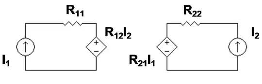

It then occurred to me, that I could perhaps analysis this with Two Port Network Theory.
By Brews ohare - Own work, CC BY-SA 4.0, https://commons.wikimedia.org/w/index.php?curid=3296726
If the impedance of the antenna is mostly reactive, then it would seem like there's not much lost if I keep the trans-match at the rig.
Is this a valid understanding ? If not, how would I determine the impedance of the coax and antenna ?
If $I_1 = I_2$,
$$ Z_{tot} = Z_{coax} + Z_{antenna} = (50 + 0j) + (23 + 300j) $$ $$ Z_{mag} = \sqrt{73^2 + 300^2} \sim 309 \Omega $$
