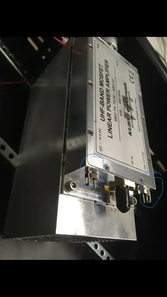

I've got two Kuhne's HPAs rated at 12V, 10Amps. The HPAs have power connectors circled in blue. Is there a specific jumper with a compatible head that I could plug directly into this connector? I'm trying to avoid soldering if possible.
I've seen these before, and they need to be soldered.
What you have is a solder-type feedthrough capacitor with a solder-type ground lug next to it.

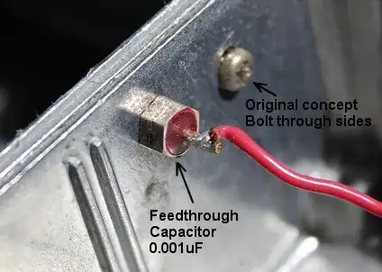

This is a feedthrough capacitor, it helps to filter the power and control lines entering the enclosure. It will have some capacitance to the body, and probably a small ferrite bead around the conductor.
You need to solder a wire to it.
But remember it's just the copper leg of a component, it's not very strong! The ground lug next to it may provide some strain relief, otherwise put a screw into the heatsink below it. If you pull the wire and snap it off, it will be a pain to repair.
Do it like this [own work]:

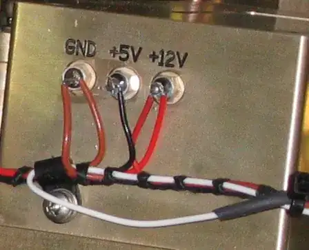

and not like this [apologies to VK6UU]:
