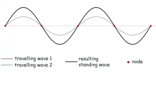

If for example there is a difference in impedance between the coax and antenna, during TX, there will be a reflection of RF energy at that junction which interferes with the original outgoing signal from the radio. This results in an interference pattern known as a Standing Wave to appear along the transmission line.
The standing wave looks like a sine wave and oscillates in time at the frequency of the RF signal from the transmitter. VSWR is a measure of the difference between maximum and minimum values of the voltage of the standing wave, and is the same everywhere along the length of the transmission line. If there are no impedance mis-matches, then there will be no standing wave and SWR will be 1:1.
