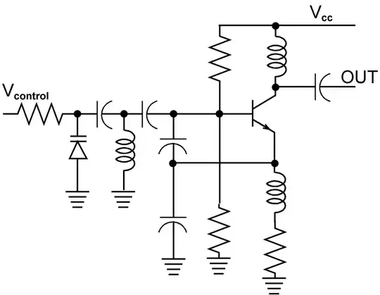

VCO

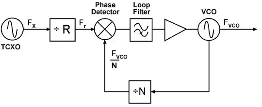

The required frequency agility would suggest an integer-N synthesizer: The possible LO frequencies all fall into a fixed raster, and could be generated from a single reference oscillator (e.g. at 10 MHz). So, there's no need for the more flexible fractional-N synthesizer, which tends to (at same implementation effort, cost) have higher spurs. Both architectures still include a VCO, but it's probably not the kind of VCO from your ham textbook, but not too dissimilar. From page 9 of the TI appnote on Integer-N and Fractional-N Synthesizers I've linked to above:
VCO
However, the crux of any receiver architecture's frequency synthesis is how to deal with correction of frequency error. (Your signal reception, especially in case of IEEE802.11a, will allow you to tell pretty exactly how much your receiver's frequency is "off" relative to the transmit frequency.)
Now, one could implement the reference clock (from which the 2.4 GHz-range frequencies are generated) as VCO itself. That, however, is a solution that is often not very desirable – the reference oscillator is one of the few things you typically can't integrate into the chip die itself, as it's a cut crystal (or MEMS silicon device) in its core, and thus not possible to make in the same semiconductor device production process as the rest of the chip. So, you'd need to deal with an off-chip VCO, with unknown characteristics and spurs. Also, you'd again need a very fine DAC to make fine adjustments.
The alternative is to digitally fine-adjust the receive frequency, simply by calculating the error frequency and applying a correction, simply by multiplying the complex-valued sample stream from the I/Q-DAC with a complex oscillation $e^{-2\pi j f_{\text{error}}t}$; while that certainly is a lot of multiplications per second (20, 40 or 80 million complex multiplications per second, to be precise), but since these happen on digital numbers, that's easy to integrate into a digital chip – and thus technologically and economically feasible.
