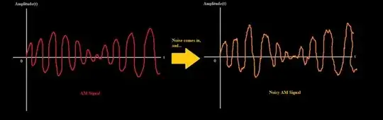

Well, one of the main reasons of saying FM may perform better than AM in terms of signal fidelity is hidden in the information transmission methodology.
It is known that an AM signal $a(t)$, if we consider $m(t)$ as the information or message that is going to be exchanged and $c(t) = A_{C}sin({2{\pi}f_{C}t + \phi)}$ as the carrier of the transmitter, can be written as;
$$a(t) = m(t)c(t) = A_{C}m(t)sin({2{\pi}f_{C}t + \phi)}$$
$A_{C}$ is the maximum amplitude of the carrier wave and $f_{C}$ is the frequency of that wave. I've also added that phase difference $\phi$ so as to show the more general formula of an AM signal. So, it is apparent that the message (which, theoretically, can be any kind of information but most of the time, because of the limitations on the bandwidth in the allocated frequency spectrum which makes things, e.g. streaming a video recording, impractical to be transmitted at required, sufficiently high information rates) is encoded into the amplitude of the carrier. The receiver, in this case, finds that information signal by applying specific processes on the amplitude of the modulated signal. However, this way of communication is prone to interferences and maybe, after implementing strong filtering mechanisms, the hardest to cope with appears to be the noise.
Noise effects on an AM signal
As a result of the superposition theorem, that noise directly affects the amplitude envelope of the modulated wave which means distorting the message from the first hand. Thus, on the receiver side, the SINAD (signal-to-noise and distortion ratio) is aggravated.

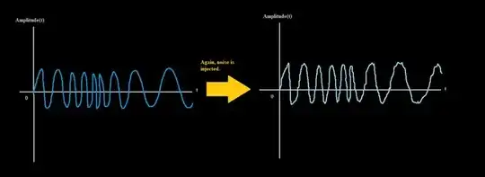

On the other hand, FM signal $b(t)$ (by using the same message and carrier waves) can be illustrated as follows:
$$b(t) = A_{C}sin[{2{\pi}f_{C}[m(t)] + \phi]}$$
Now, the information is altering the carrier frequency, i.e., the carrier frequency is the function of the message signal $m(t)$. Therefore, considering the same noise characteristics, the message is independent of amplitude-related issues.
Noise effects on an FM wave
As it can be seen from the drawing, although the noise slightly changes the amplitude of the FM signal, the frequency change of that wave is the same. So, the SINAD on the receiver could be much higher than that in the AM transmission scenario which increases the quality of the overall communications environment.
However, the FM transmitter should be equipped with very precise local oscillator waves. Otherwise, for example the phase noise on that FM local oscillator signal would act as an adverse factor as the AWGN (additive white Gaussian noise) in the AM scheme.

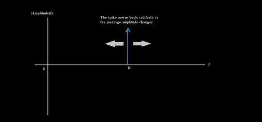

And, as to your question which is about possibility of assigning a spread spectrum feature to the FM technique: No, FM is not a form of spread spectrum but it can be considered as a frequency hopping mechanism.
An FM signal in the frequency domain
The above figure shows the ideal (theoretical), one-sided magnitude spectrum of the FM signal $b(t)$. By changing the carrier frequency, the Dirac delta moves on both directions. This may be useful in avoiding a specific jamming signal component in the spectrum. But, the spread spectrum technique is a different topic which utilises rectangular pulse signals (here, digital systems come into play) and coding. Very briefly, by resorting to the relationship between temporal-spectral information when expanding-compressing signals in the time domain, the spread spectrum can be achieved.
