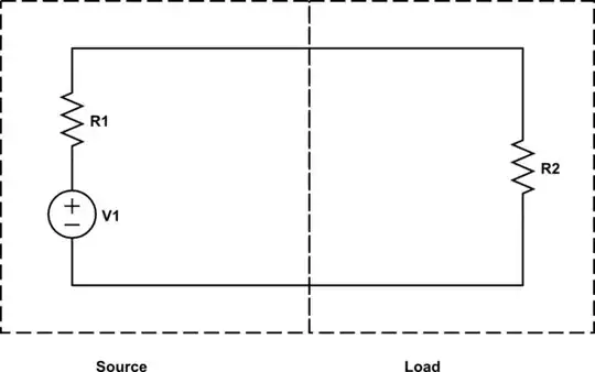

Now in one sense of course this is true, because whenever we talk about "output impedance" we get this sort of picture (which I've cribbed from https://electronics.stackexchange.com/a/423884/9043):
Schematic divided into two parts: a voltage "source" with its own resistor R1 versus a "load" with its own resistor R2
simulate this circuit – Schematic created using CircuitLab
And so when the "source" and "load" resistances are matched as we all know they "should be", it's inevitable that only half the power would make it to the load!
But this is also rather astounding! So basically the "ideal condition" (matched load to source) which we all know is required for "maximum power transfer" implies by its very definition a maximum efficiency no greater than 50% under any circumstance?!

A partial answer, more about matching than about transistor amplifiers:
you need to match the output impedance of a transmitter to the input impedance of an antenna
No this is the wrong way around. If you have control of R1, the source impedance, for maximum power transfer (and efficiency) you want it as low as possible. This is what you see in practice, with audio and RF amplifiers and also with Honda generators.
A true 50 ohm source impedance is only seen in lab equipment, where you need to be certain the forward power is the same into any load impedance, and this is usually done by having an attenuator right before the port.
Off the shelf transmitters will have an impedance specification, that they're designed and tested to work with. We chose or tune the antenna+transmission line to present 50 ohms to the transmitter because this is what the transmitter is designed for not for maximum power transfer.
In fact as its output impedance is probably quite low, a transistor amplifier would probably generate more power into a 10 ohm load than a 50 ohm load. This could overload or overheat the transistors, so most amplifiers have some sort of high-VSWR protection. (Though some just have high-current protection to protect against low impedance loads).
The discussion in Horowitz & Hill is correct for the circuit given, and it does describe what happens to very high and very low impedance antennas. But the theorem is for that simple circuit. You shouldn't assume that all transmitters labelled 50 ohms is made up of a low impedance voltage source and a resistor.

  • Not maximum power transfer - maximum efficiency. Given a constant impedance for both source and load, power transfer is maximised from source to load when the two impedances are equal. However, efficiency at this point is 50%. Efficiency keeps going up as source impedance goes down, but power transfer also drops below the maximum possible. We don't actually care about maximum power transfer - we care about efficiency - so this is fine. – Simon Farnsworth Apr 28 '23 at 16:46
The maximum power transfer theorem (MPTT) assumes that the source impedance and voltage are fixed, and asks you what load impedance gets maximum power in the load, assuming that the source is an ideal (infinite power) source in series with a source impedance. As you note, this comes up with peak power transfer at 50% efficiency.
For the MPTT to apply, $V$ and $R_S$ are fixed. We can choose a value of $R_L$ to suit our setup; to make the equations nice to look at, we'll choose $R_L = nR_S$, and look at the effect of changing $n$; we know from this that $n > 0$ in the real world.
First, let's think about efficiency. Efficiency is power dissipated in the load divided by total power, but we want to get this in terms of $n$: $$ P_L = I^2 R_L = I^2nR_S $$$$ P_T = I^2 (R_S + R_L) = I^2(n+1)R_S $$$$ \frac{P_L}{P_T} = \frac{I^2nR_S}{I^2(n+1)R_S} = \frac{n}{n+1} $$ Nice and simple; as the load impedance gets larger relative to the source, efficiency improves, and more of our total output power is dissipated in the load.
But we also need to consider the actual power dissipated in the load. This means we need to determine the current in the circuit, and then we can use our equation for $P_L$ from earlier to get power: $$ I = \frac{V}{R_S + R_L} = \frac{V}{(n + 1)R_S} $$$$ I^2 = \frac{V^2}{(n^2 + 2n + 1)R_S^2} $$$$ P_L = \frac{V^2nR_S}{(n^2 + 2n + 1)R_S^2} = \frac{V^2n}{(n^2 + 2n + 1)R_S} = \frac{V^2}{R_S}\frac{n}{n^2 + 2n + 1} $$ Because $V^2/R_S$ is a constant, $P_L$'s behaviour can be described in three parts: when $0 < n < 1$, $P_L$ grows as $n$ grows. When $n = 1$, $P_L$ reaches a maximum. When $n > 1$, $P_L$ falls, and as $n \to \infty$, $P_L \to 0$.
We can also calculate $P_S$ (the power dissipated in the source) in terms of $n$: $$ P_S = I^2 R_S $$$$ P_S = \frac{V^2}{(n^2 + 2n + 1) R_S} $$
This just tells us what we expect from efficiency - as $n$ gets bigger, $P_S$ gets smaller.
In real radios, though, we don't bother with maximum power transfer; we aim for efficient power transfer. We have a fixed $R_L$, and a fixed $P_L$ (the radio's rated power), and we want to build a source to produce this efficiently. This means that the impedance of the radio is not matched to the output, and thus we get higher efficiency, but lower peak powers.
Looking at a random design I happen to have to hand, the output impedance is around 10 Ω, driving a 50 Ω nominal load. This gets us $n \approx 5$, and thus about 83% of power goes into the load by our previous maths. The power output into the load is about 2 W RMS, and the power dissipated in the source is about 0.4 W RMS. Total current draw is on the order of 200 mA RMS, and is quite manageable for the system to offer.
If we reduced the load impedance to 10 Ω, to get maximum power from the source, we'd be getting 14.4 W dissipated in the load instead of 2 W, and we'd have 14.4 W dissipated in the output amplifier instead of the current 0.4 W. We'd also be trying to provide 2.5 A RMS or so of current at the same supply voltage, which would hurt us, since the power supply is designed to give it 250 mA RMS.
Further, if we redesigned to have a 50 Ω output impedance, we'd still get 2 W out, but we'd now have 2 W of heat dissipated in the source, not 0.4 W, and we'd thus be using about 4 W input power, not 2.4 W.
With these two design points in mind, you can see why we'd design an output impedance of 10 Ω to feed a 50 Ω load - while (assuming components could tolerate the currents and voltages involved) we could have a 14.4 W output into a 10 Ω load, or we could design for 50% efficiency and a 50 Ω output impedance, we have no reason to do that - we are happy transferring 2 W efficiently using devices whose maximum theoretical power output (at the cost of efficiency, and assuming they could handle the currents or voltages needed) is 14.4 W.
