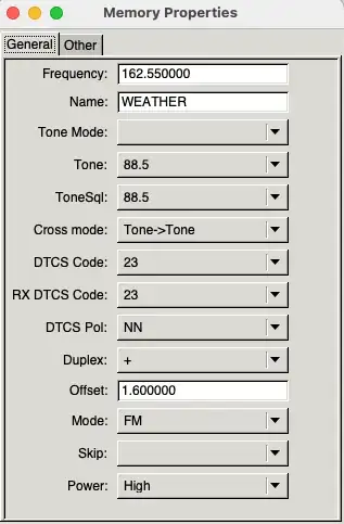

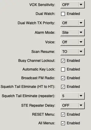

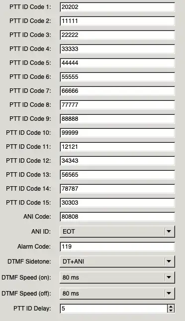

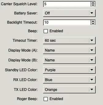

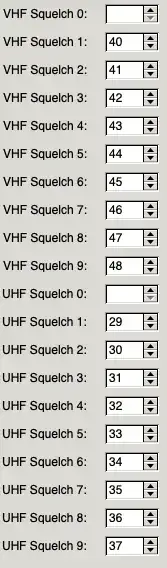

Here is my configuration :

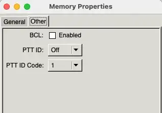

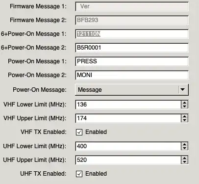

  • I don't think so, I added screenshots of my configuration in my original post. Let me know if you need more details. Thanks for your answer – C-Rock Jan 05 '23 at 15:26
  • I think Duston is onto something - but I don'ts see any mention of Tone Squelch in your screenshots. Can you look for that parameter? – mike65535 Jan 05 '23 at 16:09

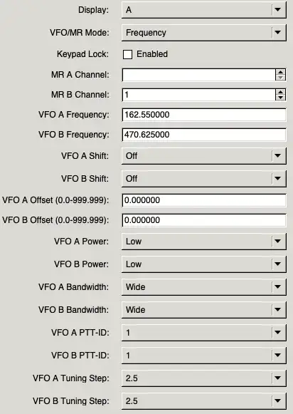

  • The settings shown are all global settings. There's no local memory channel settings or even current VFO settings, and tone squelch (TSQL) should be in either of those. The two settings relevant here are squelch mode (typically set to one of none / T / TSQL) and the tone frequency (one of 51 numbers between 67hz and 254.1hz). If in TSQL mode and you have the wrong tone, squelch will almost never open. If set right, it's a great way to not have to hear static when there's nobody talking. I'd just write a full answer here now, but Duston deserves the honors, or looked for UV5r settings. – user10489 Jan 07 '23 at 23:44

  • Hi, I added the other screen shots from CHIRP. To answer the questions from the comments : - I use CHIRP on OSX to read the UV-5r - My second uv-5r can clearly receive the weather Chanel without pressing the moni button - I cloned the faulty uv-5r from the good one and it still does not work without the moni button pressed – C-Rock Jan 09 '23 at 15:15
  • @user10489 In my experience with this radio setting the squelch to 0 is not the same as open squelch. –  Jan 13 '23 at 04:04

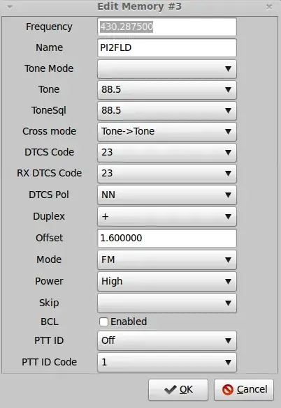

I'm not sure what software you're using, but in CHIRP, the option is on the "Other Settings" tab. You want to turn off anything CTCSS or DTS related on that menu for that channel.
Hi thanks for your answer. I don't see differences with your settings - except of the offset that was 0 for m, but event with this offset it does not work. I added the screenshots to my post.
