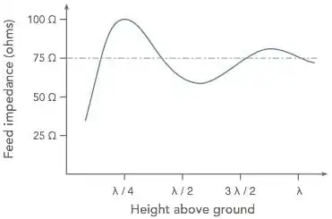

I presume you are running a 50 Ohm system (radio & trasmission line), and while the characteristic impedance, in free-space, of a dipole is ~73 Ohms, at various distances from the ground, the impedance can vary significantly;
https://www.electronics-notes.com/images/antenna-dipole-feed-impedance-with-height.jpg
So using a 1:1 BalUn, as you are, at a certain height you may be close to 50 Ohms, where at other heights you may be closer to the characteristic impedance of 73 Ohms or upwards of 100 Ohms, or low, around 37 Ohms; which means you could have anything between 1:1 - 2:1 VSWR on a 50 Ohm system. With your Nano VNA, you can check the antenna resonance, irrespective of VSWR, by looking at the R ± jX on the Smith Chart function, making sure your jX part is close to 0, or at least crosses 0 at a frequency you want as your "center" of resonance. If it stays positive through the entire frequency sweep of the band, your antenna is too long, if it stays negative through a frequency sweep, it's too short.

  • The illustration has an error on the x-axis 3λ/2 is actually 1.5 wave lengths; I'm sure the the author of the chart meant 2λ/3 or 2/3 (66.6%) of a wavelength. – Lou-in-USA Feb 16 '23 at 13:00
