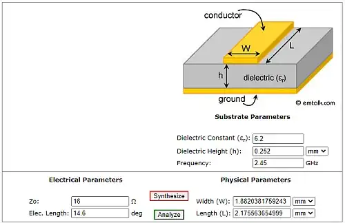

$L={1\over{\sqrt{\epsilon_r}}} {14.6\over360} {300\over2450}$ but use a real calculator because the effective $\epsilon_r$ depends a bit on the trace width.
Here's an example calculation from emcalc.com
The board must be quite thin for this to be possible at all - on a 1 mm thick board, the line would need to be 8mm wide, 1 mm long, which is a capacitor not a transmission line.
Next is a line of 25 ohms impedance, with an electrical length of just 4 degrees. I'm not sure what the point of this short line would be, but it will be 1 mm wide and 0.6 mm long.

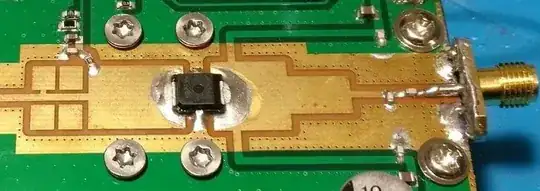

Here's a photo of an amplifier for 2.4 GHz with an SMA connector for scale, so your figures look plausible. (source: Amsat UK)
Note: 1) this is CPW not microstrip and 2) there are parallel RF-short-circuited stubs on both sides, used to supply power to the transistor.

  • As I said I have the physical board of that schematic, but trace width does not matches. For example: for region where Zo = 15.8, E=14.7 trace width is about 5mm and length also ~5mm. But according emcalc trace width must be ~twice less. – Alatriste Feb 16 '23 at 08:42
  • According your photo, how you did calculate trace width? according amplifier datasheet ? – Alatriste Feb 16 '23 at 08:55
