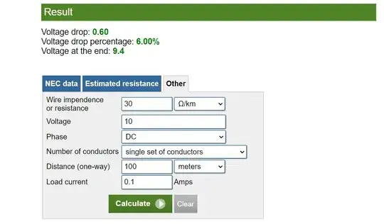

  • Please look at the attached image. So DC @ 0mhz says only 6% loss (even for 10V bulb at 100mA) while at DC @ 2Ghz 99% loss? – Svetoslav Jun 18 '23 at 10:27
    @Svetoslav there is no such thing as "DC @ 2GHz". 0MHz is the only kind of DC. But yes, the loss will be much much lower at DC. At DC the total resistance will be 80+3 = 83 ohms. If you put in 10 watts (28.8V @ 347mA), 9.64W would go to the bulb and 0.36W would be lost in the cable. – hobbs - KC2G Jun 18 '23 at 19:45
