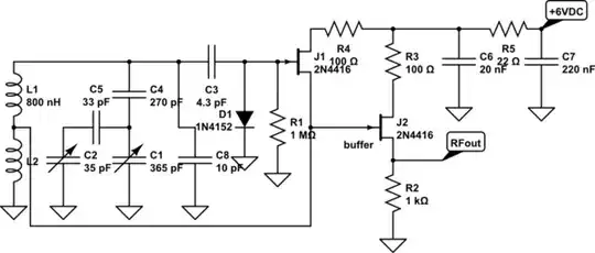

The 8640 jr. Hartley oscillator is outlined below. It uses a much larger variable, but adds a smaller variable to set the upper frequency.
schematic
simulate this circuit – Schematic created using CircuitLab
This oscillator is designed to cover at least one octave span, from 13.6MHz to 31MHz. The big question is: could it be adapted to use a 25pf variable substituting for that big 365pf variable?
C8 should be eliminated, because it violates our minimum requirement of 6pf. The designer actually started C3 at 2.5pf, but found amplitude was feeble at one frequency-end. Perhaps a 2.7pf could work here.
C2 and C5 would also be left off.
The 25pf variable substitutes for C1. Unfortunately, the 800nH inductor would now cause oscillation at a very high frequency, so a much larger inductor would be needed, but it should be built so its self-resonant frequency is as high as possible.
A 5uH inductor combined with 6-25pf variable resonates from 29.1MHz down to 14.2MHz; barely an octave. Building it to achieve this range will be difficult, because of inevitable stray capacitance.

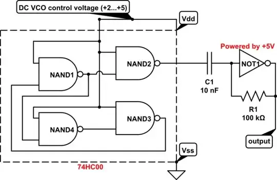

Texas Instrument High-speed CMOS Logic Data Book suggests an alternative oscillator that covers much more than one octave frequency range. It's frequency is varied by means of a variable voltage (it is classed "voltage-controlled-oscillator" VCO):
schematic
This 3-stage ring oscillator provides a square wave output that ranges fairly linearly:
  • VCO control voltage 1.5V yields output frequency of ~ 5 MHz
  • VCO control voltage 4.8V yields output frequency of ~28 MHz.
Its square wave output should not be an impediment for most types of mixers, although some mixers might want a smaller amplitude than 5V. Output can easily drive the flip-flop chain-of-5 directly. An approximate equation is given relating the control voltage to output frequency:
$ F_{out} (MHz) = 5.8\times V_{control} $
I believe that the 74HC00 DC supply pin #14 should also be connected to $ V_{control} $ , however note that the inverter stage should be powered from a fixed +5V DC supply - it converts the VCO's variable amplitude to a standard logic swing appropriate to drive the flip-flop frequency dividers.

  • Interesting ring oscillator design! But you're missing the important information from [the book](https://archive.org/details/bitsavers_tidataBookogicDataBook_23574286/page/n769/mode/2up): the control voltage needs to *also* be the supply voltage of the 74HC00! (I think not drawing the power supply pins in that schematic was an unfortunate choice by the 1984 author of the diagram). Also note that the speed is temperature-dependent, and ring oscillators are typically a good way to quickly cycle through different temperatures :) – Marcus Müller Aug 26 '23 at 09:42
    @MarcusMüller Didn't realize this book is online! Last paragraph *does* point out that HC00's Vdd should go to V_control. Have edited the schematic in an attempt to make this more clear. I'd bet this simple VCO has a few other less-than-ideal qualities...V_control should be carefully filtered with a bypass capacitor: it tends to be "glitchy". But in the OP's intended application, this VCO should be OK - it certainly is simple! – glen_geek Aug 26 '23 at 13:02
  • @glen_geek yeah! I was a bit angry because I had myself not come up with the idea of using any logic series where thresholds and speeds depend strongly on supply voltage for ring oscillators! – Marcus Müller Aug 26 '23 at 13:58
