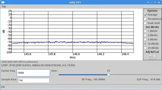

EDIT: Here are some screenshots of the spike I'm referring to:
FFT tuned
This is an FFT of the received spectrum through an antenna tuned for the 2M band. Everything is nice and flat.

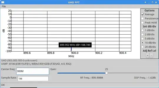

FFT detuned
This is an FFT of the spectrum through the same antenna but at a completely unworkable operating frequency. The middle is a bit noisy but still shows the spike at the center frequency well.

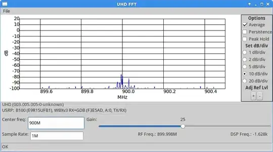

Here's the FFT at the same frequency, but with no antenna connected. The spike is clearly visible here, and this is what I'm interesting in learning about.

That is probably 1/f noise. This is noise where each octave has equal power. At lower frequencies, each octave is narrow, and thus has more power per unit frequency. It is ubiquitous in every electrical circuit, and in fact a great many physical processes.
This will always appear at the center of your FFT, regardless of where the radio is tuned, as the center of the FFT always corresponds to the frequency of your receiver's VFO input to the mixer. For example, if the VFO is tuned to 900 MHz, then a 900.01 MHz signal will appear at 900.01 - 900 MHz = 10 kHz, after mixing. 900 MHz appears at 0 Hz after mixing, the lowest frequency possible.
1/f noise is present in all electronics, and this is why you observe it even with no antenna connected. It can originate in the components that comprise the gain stages of the receiver like resistors and transistors, and noise so generated then goes on to be amplified and made visible in the FFT.
Better, and usually more expensive engineering can reduce noise like this, but in your particular case it would have negligible benefit. If you compare the scale on the left, this noise is significantly below the RF noise floor when you have an antenna connected. Consequently, you will realize very little benefit from reducing the noise.
