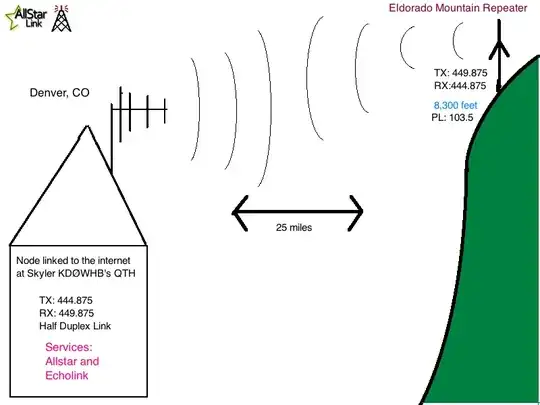

I have set up an AllStar link system to a repeater depicted in the picture below:
The repeater is under NØMHU's call, and my node is under me, KDØWHB. With permission, I service EchoLink and AllStar to the machine for wide coverage access.
I am curious, who is responsible for what if someone who does not ID gets on and potentially performs illegal action?
Scenario 1) Illegal transmitter gets on Eldorado, and transmits through my QTH node to another node remotely.
Scenario 2) Illegal transmitter gets on a node I am linked to, and it gets aired on Eldorado.
Scenario 3) Non-liscensed ham manages to get on an EchoLink account (or the AllStar web transceiver) and transmits to Eldorado, and a remote node I am linked to.
Who is responsible for what? With any of those scenarios, is my call held responsible?
"A control operator needs to be listening at all time to make sure nothing illegal happens where your node is responsible from a local transmission."
Someone told me that. (yes, the same guy from prev. question) Is that true? Will I be responsible for someone getting on my node and doing "bad stuff".
I know all of the repeater rules, but it gets complicated with my weird setup.
