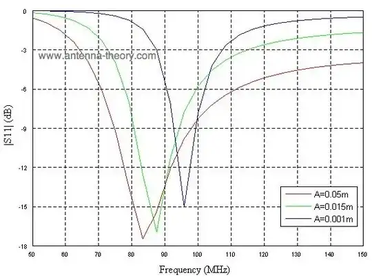

Antenna-theory.com has a good article on "thick" dipoles, summarized by this graph:
dipole bandwidth vs thickness
Here, "A" is the thickness of the dipole, and the length of each dipole is 1.5m. As you can see, as the dipole gets thicker, the resonant frequency goes down and the bandwidth goes up.
However, this is only but one of many variables in actual antenna construction that might change the resonant frequency. The effect of thickness is minor enough for reasonable thicknesses that it's best to initially make the antenna bit long, and then trim or otherwise tune it by actual measurement.
Because the support structure of your tower is probably very small relative to the wavelength at which you intend to operate it, it will behave almost identically to a solid bar of metal of similar outside dimensions. It will not make your signal horizontally polarized.
