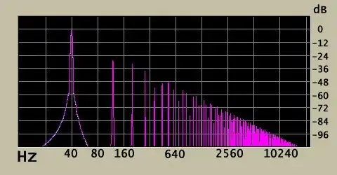

Clipping is what we call it in the time domain, where it looks like someone clipped off the tops and bottoms of all the peaks with scissors. In the frequency domain, this generates a bunch of harmonic images. Here's a spectogram of a 40 Hz sine wave that has been clipped:
spectrogram of clipped 40 Hz sine wave.
You can see here that the 40 Hz signal is repeated at each odd harmonic:
  • 120 Hz (40*3)
  • 200 Hz (40*5)
  • 280 Hz (40*7)
  • etc...

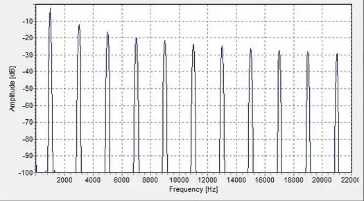

This is the same harmonic progression as a square wave. This makes sense: if you clip a sine wave enough, it becomes a square wave. The spectogram above has a logarithmic frequency scale. On a linear frequency scale, the harmonics look evenly spaced:
spectogram of square wave
