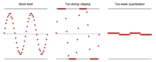

  • If the analog signal is too strong, then the logically corresponding digital values are not representable in the numeric range of the samples, and the ADC will substitute the maximum or minimum possible output; this is known as clipping, which from a signal processing perspective is an extreme form of nonlinearity.
    If you have clipping, it can be observed as the appearance of spurious signals which are copies of actual signals in the received band at different frequencies.
  • If the analog signal is too weak, then its presence will not manage to make even one bit of difference in the digital output. More practically, well before the one-bit point you will be losing information due to the digital sample values being too coarse-grained to accurately represent the signal. This can be thought of as a source of noise, called quantization noise.
The above image shows a sampled (50 samples) and quantized (5 bits) sine wave with different amplitudes, showing each of the above effects. Note in particular how even the relatively nice-looking sine on the left has slightly irregular points (because the sine function's real-number values get rounded to the closest representable value): this is an example of quantization noise.
