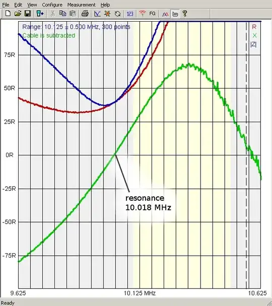

Resonance is at a particular frequency where reactance is zero, and thus current and voltage are in phase. To illustrate, here's a plot of the feedpoint resistance, (R) reactance (X), and impedance magnitude (|Z|) of my backyard trap vertical on 30 meters:
Notice how at resonance the resistance is not 50Ω, so the SWR here is something higher than 1:1.
There's another resonance around 10.62 MHz, but here the resistance is off the chart. As we'll see in the next chart, although the antenna is resonant here, the SWR is very bad.

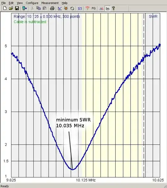

Here are the same data, but plotted as SWR:
The minimum of the SWR dip is not quite at the same frequency as resonance.
(You can also see that I need to go out there and tune this antenna!)

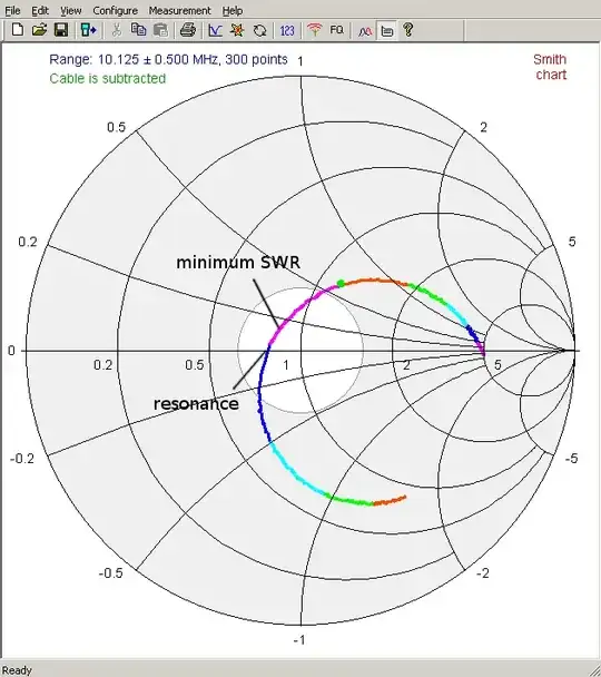

A Smith chart is a nice way to visualize both impedance and SWR on the same chart. Here are the same data again:
The horizontal line in the middle represents all the resonant points, that is, all the points where reactance is zero.
The very center of the chart represents 50+0jΩ, and a 1:1 SWR. SWR is measured by the distance from the center, and that bullseye in the middle represents an SWR of 1.6 or better.
And you can see the curve gets a little bit closer to the center just a bit away from resonance. The difference is small enough to barely matter in practice.
You can also see the curve continue around until it hits the middle line again: that's the other resonance with a bad SWR.
It's possible to have an antenna which dips into that 1:6 SWR circle from above or below, and never crosses the 0 reactance line at all. With self-resonant dipoles and verticals the resonant impedance is a decent match and will be near the center, but with other kinds of antennas there might be a matching network involved which creates a very different trajectory through the Smith chart.
