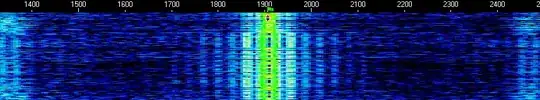

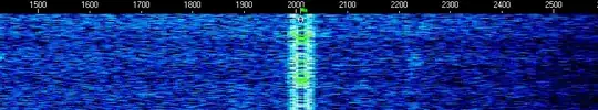

For digital modes, you really don't want this to happen. That power in the harmonics means you are occupying more bandwidth than intended: it wastes your transmitter's power and interferes with nearby stations. Here are some waterfall examples of PSK31 from an eham.net.
Here's a good signal, with no visible distortion:
psk31 signal with no distortion
And here's one with extreme distortion:
See how the signal has "echos" above and below the center frequency? That's harmonic distortion caused by clipping.
