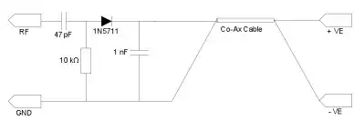

So: is it likely that a simple, common multimeter can measure RF voltages? I've seen this circuit which suggests that it's not possible and you have to put something in between the RF and the multimeter:
However, they're rectifying the RF voltage, so they in fact measure with the DC input. My multimeter has an AC input - it's unclear to me if a circuit as this one is still needed in that case.

The rectifying circuit in your question is a good solution. Note that you don't really need to use coaxial cable: since the output is DC, it hardly matters what kind of cable you use. The "cable" might just be the leads of your multimeter. You can also stick a sensitive analog meter (something on the order of microamps) directly on a circuit like this and get a decent RF detector.
With an ideal rectifier, what you will measure with the meter (set to DC) is the peak-to-peak voltage of the RF input. Of course, no matter what diode you use, it will be anything but ideal at RF. There is at least the forward voltage drop of the diode to take into account (which can be reduced by using a Schottky or germanium diode). Real diodes also have capacitance, and all the components are going to have some inductances, and these reactances are going to filter the input signal in a way which may or may not be significant for your frequency of interest. However, if all you care about is a qualitative measurement of the input, a simple diode rectifier is quite sufficient.
