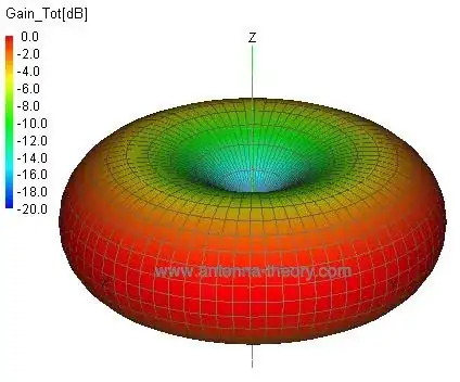

antenna-theory.com provides some nice images of the ideal case. A half-wave dipole in free space along the vertical has a radiation pattern like this:
1/2 wave dipole radiation pattern

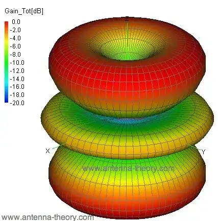

A 1/2 wave antenna on 2m is a 3/2 wave antenna on 70cm. That radiation pattern looks like this:
3/2 wave dipole radiation pattern
Of course you are not using a dipole, but a vertical. A vertical on an ideal ground plane has an identical pattern to a dipole, but with the lower half removed. On a ground plane of limited size and conductivity, some of the low angle radiation is lost, but otherwise the pattern is pretty much the same.
In a mobile installation, the ground plane can be very far from ideal, and the radiation pattern will depend more on the ground "plane" than the antenna, so the actual pattern will not resemble these images at all.

    In other words, a quarter wave antenna for 2m,fed at 70cm, might be well matched but doesn't radiate much towards the horizon. This is why any simple dual band whip has an inductor near the bottom, to bring it a bit below 3/4 wavelengths at 70cm. – tomnexus Feb 06 '15 at 14:38
    @tomnexus yes, maybe. The inductor might be there just to shorten the whole thing, depending on the particular antenna. – Phil Frost - W8II Feb 06 '15 at 16:14
