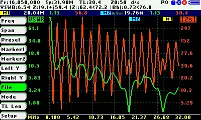

I'm building a trap dipole for the high HF bands, 10 / 12 / 15 / 17.
So far what I've got in the air is:
  • The 10 meter section (4.92 meters, 16.14 feet, resonant at 29Mhz)
  • The 10 meter traps (8pF cap in parallel with a 4µH inductor, resonant at ≈28Mhz)
  • The 12 meter section (80 cm, 31.5 inch)
                8pF/4µH                             8pF/4µH
             ----{10M}------------{Balun}------------{10M}----
            0.4M        2.46M        ║       2.46M          0.4M
                                     ║ 30.4M coax
Now take a look at the output from my antenna analyzer: What my SARK110 sees
Whhaaaat... Well, I'm happy with the 10 meter resonant point (given by M1) but what the heck happened next? I read somewhere that traps would electrically shorten all subsequent dipole sections, but i'm not sure what to make of this. Why would the 12 meter section be so far out of tune. Any ideas?
Turingrad
  • 75
    Not completely sure but don't think the TL parameter should be set for this measurement. Doesn't that add a non existing piece of transmission line for simulation? – s3c Feb 11 '15 at 10:10
    Is that diagram really accurate? Just looking at the 10m section, you have 9.84m of wire, which is about a full wavelength (not a half wavelength, as I'd expect...) – Phil Frost - W8II Feb 11 '15 at 12:27
    The answer, briefly, is that at frequencies lower than the trap's resonant frequency, the trap looks like an inductor, and functions like a loading coil. It's effect is somewhat diminished by being near the end instead of at the base, but [I'm a bit unclear on the exact math](http://ham.stackexchange.com/q/3606/218). – Phil Frost - W8II Feb 11 '15 at 16:20
  • s3c: your completely correct, I will correct the TL parameter. – Turingrad Feb 12 '15 at 01:07
  • Phil Frost, The diagram was not accurate. The 4.92 meters was the length of the entire 10 meter section. I have corrected it in the diagram. So I just need to shorten the 12 meter section until it's resonant at the desired frequency. I'll get back to you. You should put that comment down as an answer for the metrics. – Turingrad Feb 12 '15 at 01:16
  • [This article](http://degood.org/coaxtrap/) from NU3E describes his foray into trap dipole design and building. Consider reading the Appendix section. It also explains how the trap behaves at resonance. – sessyargc.jp Feb 12 '15 at 04:45
  • [W8JI also has some very good stuff on traps](http://www.w8ji.com/traps.htm). In particular, building efficient traps: trap losses are highest at resonance, so you might want to move the 10m trap resonance a little farther away from your operating frequency – Phil Frost - W8II Feb 12 '15 at 15:52
  • @s3c with the parameters shown (SWR, |Z|), adding any length of transmission line has no effect, since transmission lines just move you around a constant-SWR circle on a Smith chart. – Phil Frost - W8II Feb 12 '15 at 15:59

  • Further pruning suggests that I will need a negative length of wire to me resonant at 24.9 as desired. Does anyone have some anti-copper I could borrow? – Turingrad Feb 13 '15 at 06:34
  • @Turingrad Thats....interesting. Have you verified the resonant frequency of your traps? If its off a bit, then on 10m there can be significant currents on the 12m sections, and depending on which way the trap is off, that can make the 10m resonant point go up or down. Is the 10m section, with no traps, resonant at approximately the same point as it is with traps? (the hypothesis here being the trap is off, and you've made the 10m sections too long to compensate, and now they are too long for 12m also) – Phil Frost - W8II Feb 13 '15 at 12:43
  • "the hypothesis here being the trap is off, and you've made the 10m sections too long to compensate, and now they are too long for 12m also" This rings true and it's just the kind of mistake I would make. I'll let you know as soon as I do. – Turingrad Feb 13 '15 at 16:51
