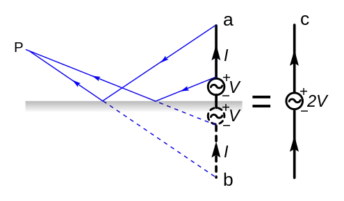

Any monopole antenna such as the ATAS-120 is designed with the assumption that it will be mounted on a ground plane. The geometry of the ground plane is important. At radio frequencies, a sheet of metal such as the roof of a metal car is reflective, just like a mirror. Because the ground plane is reflective, an image antenna is formed below the monopole, making it look like a dipole.
monopole image antenna
"Monopole and image antenna" by Chetvorno - Own work. Licensed under CC0 via Wikimedia Commons.
If the antenna is mounted on anything other than a plane, then there is no "mirror", so you have no image antenna. Consequently, you no longer have a monopole antenna.
