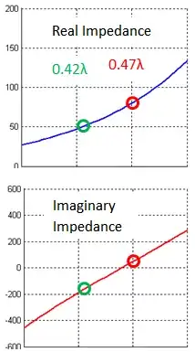

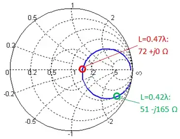

First, a bit about dipole impedance. The impedance of a dipole is 73 Ohms at resonance, but away from the resonant frequency the impedance is different. At frequencies lower than resonance, i.e. when the antenna is too short, it is capacitive, and its resistance is lower.
The Smith Chart is the usual way of plotting this. 50 ohms is in the middle, short circuit on the left, open circuit is on the right.
Dipole on smith chart
If it makes more sense, you can see them on a regular X-Y chart.
Dipole on x-y chart
It's fairly simple to choose a point where the impedance is 50 -j something ohms. Then to match the antenna, only a series inductor is required. Please excuse my wobbly inductors.

This can also be done on the Smith chart.
The two short-circuited stubs each need to contribute about 80 ohms of reactance, so they will be a bit over 1/8 of a wavelength long. They're further contracted by the velocity factor of the coax.
The inductive reactance cancels the antenna capacitive reactance, resulting in a perfect 50 Ohm match.

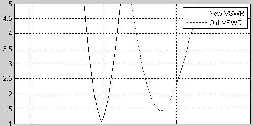

First, about bandwidth: The capacitance of the antenna and inductance of the stubs both change over frequency. The antenna gets more capacitive at frequencies below resonance, requiring more inductance to match, but the inductance of the stub drops at lower frequencies. This leads to a reduced bandwidth from this antenna, as compared to one matched with a transformer or some other way. Note the narrow VSWR curve on the left. In fact, if your radio could tolerate a VSWR of 2:1 or more, you'd be better off not using any coax stub to match it.
Bandwidth plot
This makes me think this isn't such a great choice of antenna - the ham bands are already wide enough that a regular dipole isn't perfectly matched across the band, so this one will be even narrower.

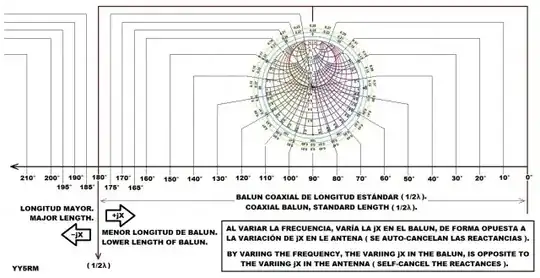

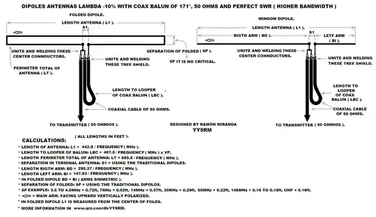

I unfortunately use google translate to write to you. This design was published in April 2012 and is based on using a Dipole Fold antenna of reduced length (Lambda -10%), whose capacitive reactance is canceled by the inductive reactance produced from the coaxial balun of reduced length.
The auto-cancellation of reactances is due to the fact that, when the frequency varies, the reactances vary in both components. this configuration improves the impedance balance for 50 ohm systems and greater bandwidth, with respect to the standard Folded Dipole.
Link: http://yy5rm.blogspot.com/2012/02/antena-dipolo-11-metros-con-coaxial-41.html
Coaxial Balun of 171°, to generate + jX:
The Folded Dipole antenna is 5% smaller than the standard, to generate -jX in the complex impedance.
This is an image of the Folded Dipole antenna of 1/2λ -10% ( 5% less than standard ), for 50Ω systems and self-canceling reactance by the coaxial balun of reduced length by 171 ° ( The standard coaxial balun is 1/2λ = 180 ° ).

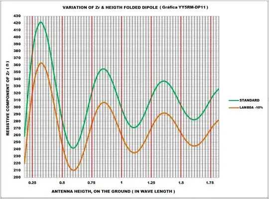

In VHF and UHF, the antenna height is generally higher than 3λ and the folded dipoles are around 280Ω → 300Ω.
In HF 20, 40 and 80 meters the antenna impedance generally approaches 240Ω → 430Ω and with any 4:1 balun it could achieve good balance in 50 ohm systems, therefore it will not always be necessary to reduce the length of the antenna to generate capacitive reactance, or use coaxial balun of reduced length (171°) to auto-cancel. Simply varying the height a bit will suffice.
This antenna of 1/2λ -10%, have greater bandwidth and better coupling in 50Ω, but it is less efficient than the standard of 1/2λ -5%.
In the trials, this was the response of the virtual and field analysis, obtained from the approximate relationship, between the impedance & height of the Folded Dipole:
