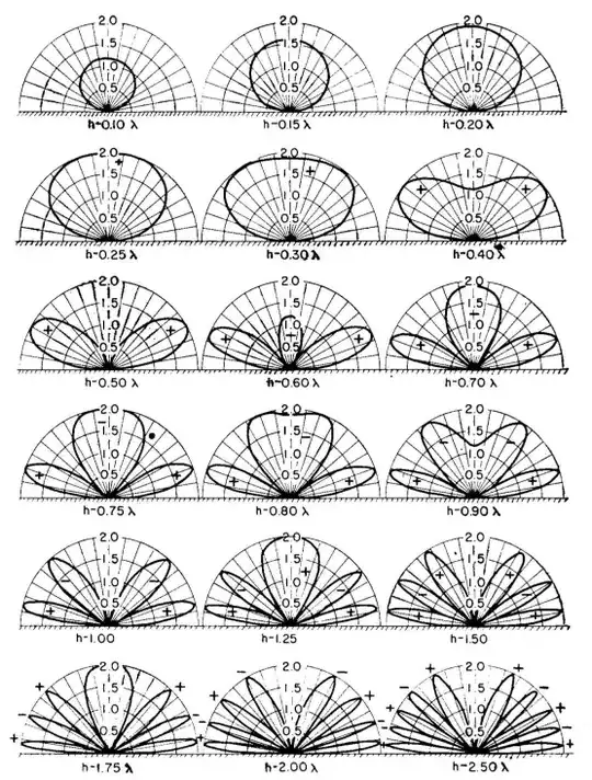

To add to what Dan is saying, for (horizontal) dipole antennas, ground height is important because although a dipole doesn't require ground to work, ground is still a (lossy) conductive plane, and you still get an image. That is, it appears that there's another dipole, fed in anti-phase, underground. Even if nothing in your transmitter or antenna is connected to the ground, your antenna will be capacitively coupled to the ground. There is no avoiding it.
If the dipole is close to the ground, then the currents in the ground can be quite strong, incurring significant resistive losses along the way. You could put radials (or any conductive mesh, really) in the ground to mitigate this.
But also: this image makes your dipole a kind of phased array. Depending on the spacing of the antenna and it's image, this might make a phased array that helpfully directs most of the RF energy at the horizon (low takeoff angle, desirable for HF DX exploiting skywave propagation), or unhelpfully straight up (useless, unless you are trying to exploit NVIS propagation on communicate with something in space).
Radio Antenna Engineering has a more detailed explanation, and this:
One interesting thing to note about this image: you can't get maximum gain in any direction until the dipole is $0.25\lambda$ high. Remember, the image is twice this distance away, and anti-phase. Below this height, in any direction you will get at least partial phase-cancellation. At $h=0.25\lambda$, you have two antennas, in anti-phase, $0.5\lambda$ apart, which makes the add instead of cancel, but only if you are directly over the antenna, which isn't useful for skywave propagation. Thus, the general recommendation to get a dipole something like $0.5\lambda$ high, which sends most of the energy at a reasonably low take-off angle, making the best of the transmit power available.

1This is an explanation of how antenna directivity gets influenced by the vicinity of ground, not about how power is lost in the ground. – on4aa Nov 02 '13 at 19:34
@on4aa yes, except for the parts where I discuss high currents when dipoles are near the ground associated with resistive losses, and how the antenna image causes phase cancellations in all directions at low heights, and how other heights can cause useful energy to be lost to space, you are right. I'll add that this is complementary to Dan's answer. Oh wait. That's already the first sentence. – Phil Frost - W8II Nov 03 '13 at 02:59
