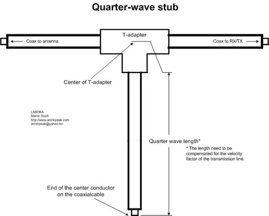

Quarter wave impedance transformer and quarter wave stub
The input impedance Zin of a length of coax depends on four factors: 1) its characteristic impedance, Z0, which is independent of the RF frequency; 2) its load impedance, Zload and 3) its length in terms of wavelength, the latter both at the fourth factor: the frequency of the applied RF. Note in all this that the wavelengths are in terms of the reduced velocity of RF in the feeder. The formula relating these is complex, but one simple case is often used, however note that this formula applies only to quarter wavelength lines:
                 Zin  = Z0²  / Zload
Basic principle is that, since a 1/4 wave length of transmission line obeys this formula, it is useful in two different ways.
The first is a quarter wave stub. This is connected across the feeder line, and and acts as a filter, at the frequency it is a 1/4 wavelength of. There are two cases: the first is if the far end, is an open circuit, Zload is infinite, then Zin is zero, and we have a notch filter at that frequency.
I have not seen any mention of a use for the second case, a short circuited stub: its input impedance would be infinite, with no effect on the transmission around its 1/4 wavelength frequency.

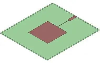

The second use is a quarter wave matching transformer. enter image description here
Using the formula we see that we can match Zin to Zload by a line with a suitable Z0. This has applications when we want to match a fixed load impedance, e.g. the input impedance of an antenna, to a fixed feeder impedance, say that of a transmission line, by inserting into the line a quarter wavelength of a different transmission line with a specially chosen characteristic impedance. That is, by having a mismatch at both ends, you choose a line impedance so that the two end impedances are the ones in your circuit. This is difficult with coax because there are only a few fixed values of Z0 to choose from. It can be more easily be applied to parallel lines, because their impedance can be changed by altering the diameter and spacing, and in microwave applications where the line is in the copper of a double sided printed circuit. For example, in the figure, a short 50 Ohm microstrip transmission line is matched to a square patch antenna (impedance typically 200 Ohms or more) via the thinner 1/4 wavelength microstrip line with a Z0 chosen to make the match.
