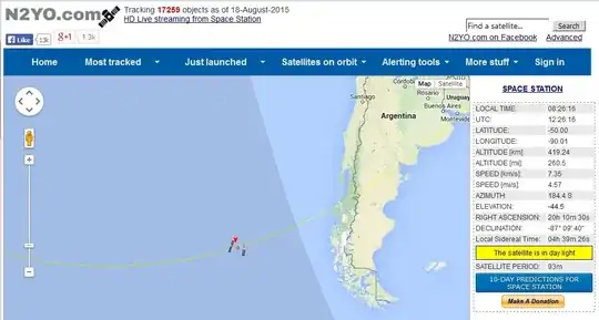

n2yo.com is a wonderful resource for keeping track of all of the orbiting satellites. It has many resources for tracking info to enter into tracking software and other places. It also shows a live google map of the location of each satellite.:

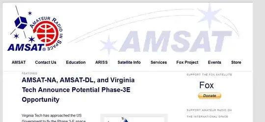

amsat.org also has a wealth of information about contacting and tracking the satellites including uplink and downlink information and tips.: enter image description here
